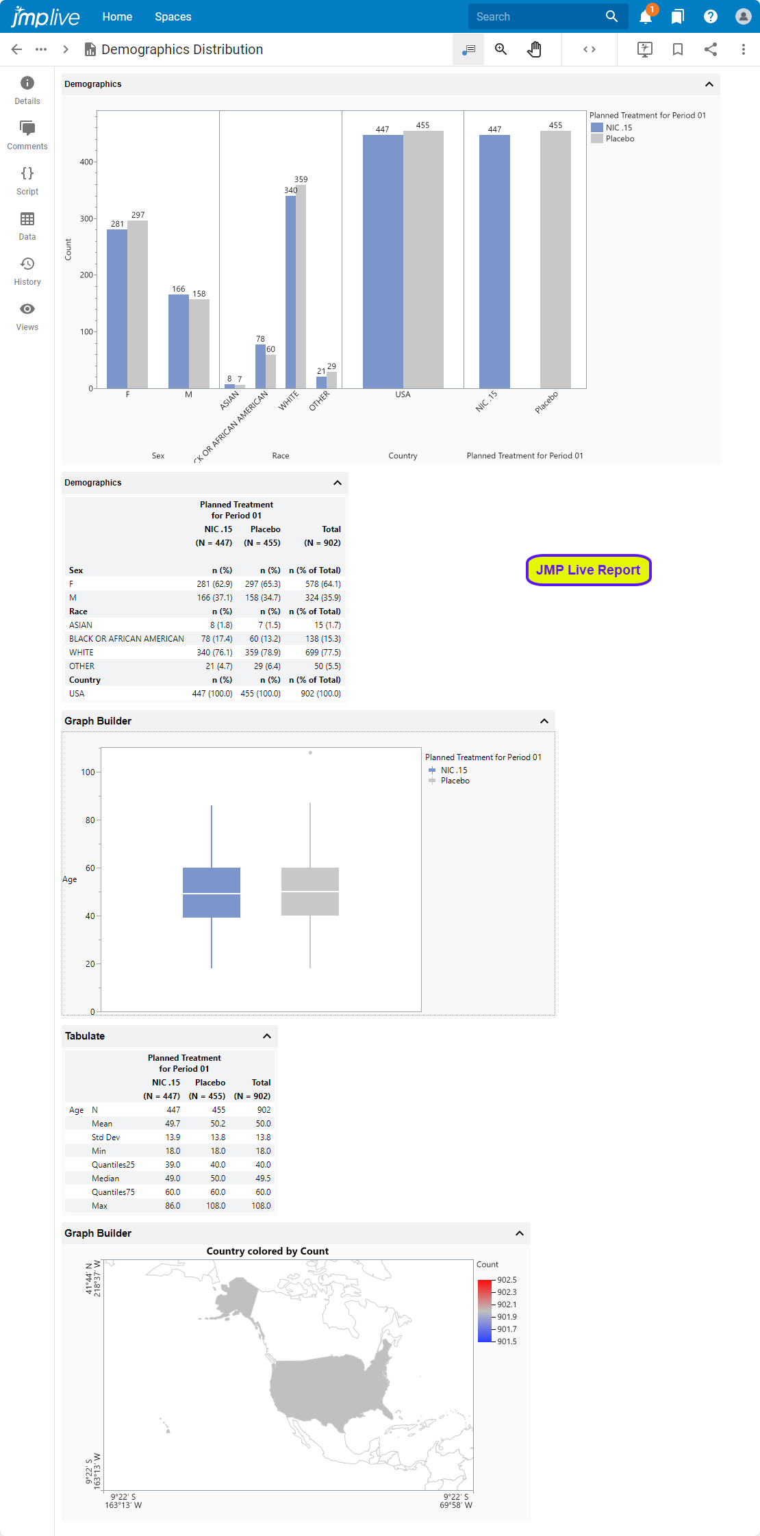

The JMP Live Report
The JMP Live Report, shown below, was generated after running the Demographics Distribution report using the Nicardipine sample data set.

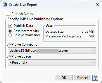

The Create Live Report window opens.
Report Options
The following options enable you to tailor the JMP Live report to your specific needs:
Publish Notes
Check the box to append the study notes to the end of your JMP Live report.
Publish Data
Check the box to include all data sets with your JMP Live report. You can choose to format the data for Best Interactivity, where all supported aspects of the report are fully interactive, or Best Performance, where images and graphs are not interactive, but supported data in the rest of the report remains interactive.
Note: If your data set is large, you might choose this option to increase the responsiveness of the report.
Data
The size of your data set(s) is shown as the Dataset Size:.
JMP Live Connection
Displays the URL to which you are publishing.
JMP Live Space
Use this widget to specify the space within the server where your report will be placed.

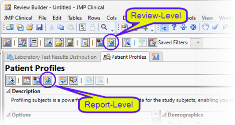

There are two Create Live Report buttons on the Review Builder, one for publishing the active report and one for publishing the entire review.
| 8 | Click the Report-Level button to publish the active report only (in this example, Patient Profiles) to JMP Live. |
| 8 | Click the Review-Level button to publish the entire review to JMP Live. |

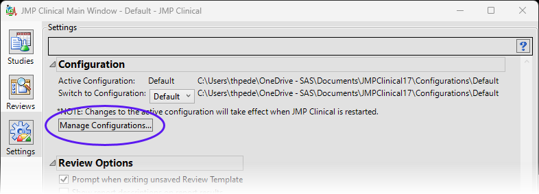

| 8 | Open JMP Clinical and click on the Settings button. |
| 8 | Click |

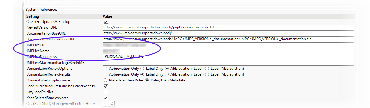

| 8 | Add your assigned JMP Live URL and JMP Live Name to the appropriate rows in the System Preferences box on the Manage Configurations window. |
| 8 | Click to close the Manage Configurations window. |
Note: The JMP Live URL is the URL to the JMP Live instance. If more than one JMP Live instance, separate with vertical bars (|). The JMP Live Name is the name of your choice corresponding to each JMP Live instance. If you have more than one JMP Live instance, separate with vertical bars (|).
