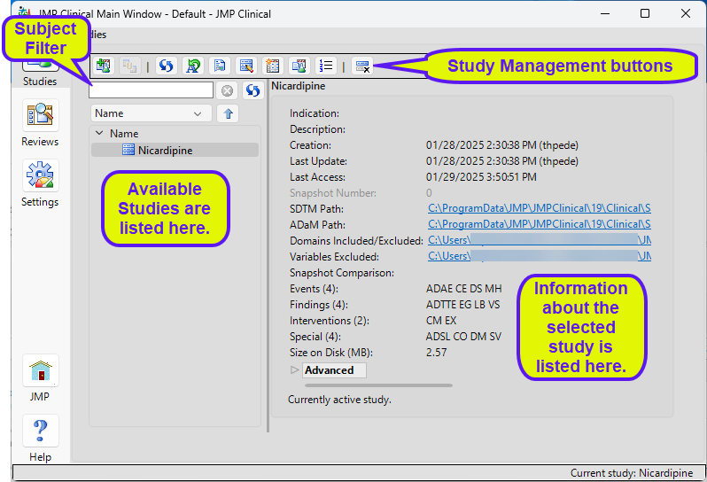

All study additions and manipulations are done on the Studies tab shown below:

Available Studies
All of the registered studies available to you are listed here. Studies can be sorted by various criteria in ascending or descending order.
8 Click to select a study. Use -click to select multiple studies.
Note: For a study to be shown here you must have read-access to both the original study data folders and a valid study metadata object file.
Study Information
Information about the selected study is shown in the panel on the right side of the window. This includes the date the study was created, when it was last updated and when it was last accessed. Additionally, the location of the study data within your file structure is shown along with a list of the domains that make up your study data. In the Nicardipine study shown above, there are 4 events domains (ADAE, CE, DS, and MH), 4 findings domains (ADTTE, EG, LB, and VS) 2 interventions domains (CM and EX), and 4 special domains (ADSL, CO, DM, and SV).

Study Management Operations
Use these buttons to add, manipulate, or delete registered studies.
