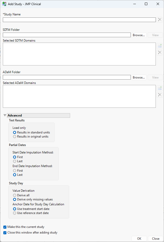

To Add a Study
8 Click to open the dialog:
8 Specify the desired options and click .
The following options are available. Links to specific documentation for each of the options are provided in the following table:
Options
Information
Study Name
The study name must conform to the Rules for Study Names.
SDTM Folder or the ADaM Folder
Use the text box to specify the location and name of the folder.
The SDTM Folder must contain at least one domain.
DM must be present.
For ADaM Basic Data Structure (BDS) Findings data, both PARAMCD and either AVAL or AVALC must be present.
Data sets can either be JMP data tables, SAS data sets, SAS Transport Files, JSON files, or a combination of these.
The same folder cannot be specified in the SDTM Folder and ADaM Folder fields.
Selected SDTM Domains
This option is used when there are multiple SDTM domain files in the SDTM folder.
Use this option to specify the SDTM domains to be added to the study. If you leave this option blank, all SDTM domains in the folder are added to the study.
ADaM Folder
The ADaM Folder must contain at least one domain.
Either ADDM or ADSL must be present.
Data sets can either be JMP data tables, SAS data sets or SAS Transport Files or a combination of these.
Selected ADaM Domains
This option is used when there are multiple ADaM domain files in the same folder.
Use this option to specify the ADaM domains to be added to the study. If you leave this option blank, all ADaM domains in the folder are added to the study.
Load Only
This setting applies to Findings results submitted in SDTM.
Choose to import either:
Results in standard units (data is imported from xxSTRESN or xxSTRESC).
Results in original units (data is imported from xxORRES).
Start Date Imputation Method
Use Start Date Imputation Method to specify whether to use the first moment rule or last moment rule for deriving missing values in the variable indicating the starting day of an event/finding/intervention.
End Date Imputation Method
Use End Date Imputation Method to specify whether to use the first moment rule or last moment rule for deriving missing values in the variable indicating the ending day of an event/finding/intervention.
Value Derivation
The Value Derivation widget enables you to derive values for any missing study day data or to rederive all study day values across the study, replacing any existing values.
Anchor Date for Study Day Calculation
Use Anchor Date for Study Day Calculation to specify the variable to use for specifying the anchor date for deriving study days for each subject.
Make this the current study
Checking this box makes your study the default study for all reports. This option is checked by default.
Close this window after adding study
Checking this box closes the Add Study window once the study has been added. This option is checked by default.
Note: When adding a clinical study and assigning both ADaM and SDTM domains, the ADaM equivalent of each domain is added and the corresponding SDTM data set excluded. For example, if both ADAE and AE are present, then ADAE takes precedence and is included, whereas AE is not included.

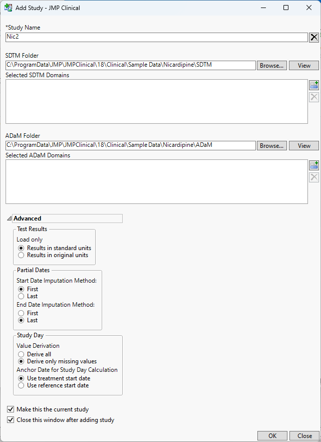

Example: Adding the Nicardipine Study
JMP Clinical ships with the data from a Nicardipine study. The data files are located in the Sample Data in your Installation directory (typically C:\ProgramData\JMP\JMPClinical\xx\Clinical\Sample Data\Nicardipine for Windows machines and /Library/Application Support/JMP/xx/Clinical/Sample Data for MACs). In this example, we add a clinical study we call Nic1.
Note: The C:\ProgramData\ directory may be hidden by default. Click View > Show > Hidden Items to view.
8 Click to open the Add Study dialog.
8 Specify the name of the study.
8 Specify the file paths to the SDTM and ADaM folders either by typing the path directly or clicking and navigating to the folders.
8 Accept default setting for all other options.
The completed dialog appears as follows:
8 Click to add the study.
When the add study process is complete, the following Results window appears.
When a study has been successfully added, the new study appears in the Studies window.
