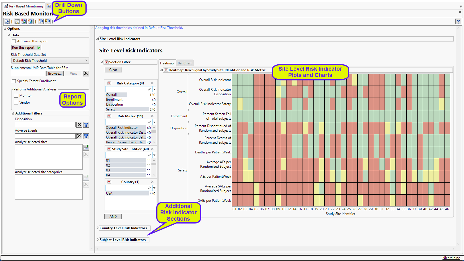

Report Results Description
Running Risk Based Monitoring with the default options for the Nicardipine study generates the Results shown below. By default risk-indicators are calculated at site, country, and subject levels. A heat map and a bar chart are provided for both site and country level. Associated data tables are also provided.
The Report contains the following elements:
Site-Level Risk Indicators

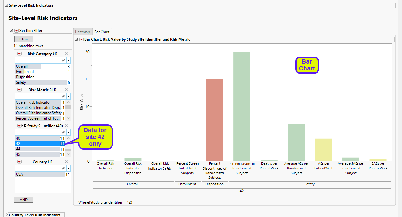

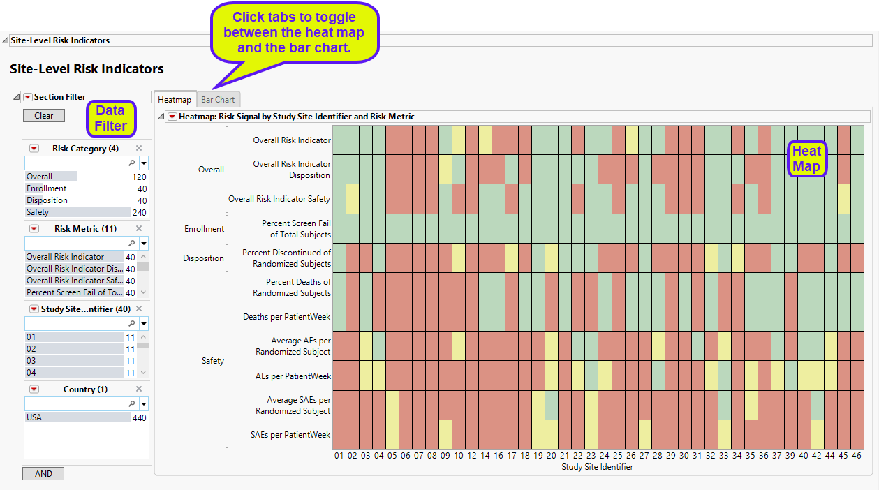

The Site-Level Risk Indicators section contains the following elements:
| • | A heat map of the various risk indicators by Site Identifiers. Individual blocks are colored by the relative severity of each indicator at that site: red = severe, yellow = moderate, green = mild or none. This section enables you to view the distribution of risk indicators across sites, possibly identifying any outliers. |
| • | A Section Filter to filter to data of interest, for example, to risk indicators that belong to a particular site. |
| • | A bar chart showing the risk value for each indicator across the sites. The data in the following bar chart were filtered to site 42 only. |
Country-Level Risk Indicators

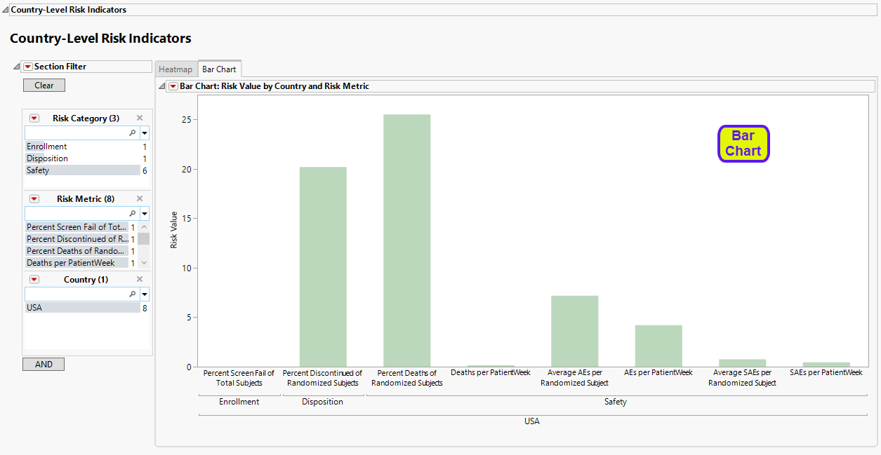

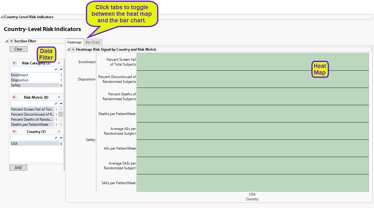

The Country-Level Risk Indicators section contains the following elements:
| • | A heat map of the various risk indicators by Country Identifiers. Individual blocks are colored by the relative severity of each indicator at that site: red = severe, yellow = moderate, green = mild or none. This section enables you to view the distribution of risk indicators across countries, possibly identifying any outliers. |
| • | Note: All of the trial sites are located within the United States, so only one country is displayed. |
| • | A Section Filter to filter to data of interest, for example, to risk indicators that belong to certain risk categories. |
| • | A bar chart showing the risk value for each indicator. across the sites. |
Subject-Level Risk Indicators

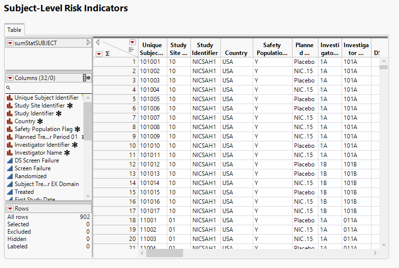

The Subject-Level Risk Indicators section contains the following elements:
| • | A table listing the risk indicators of each subject. |

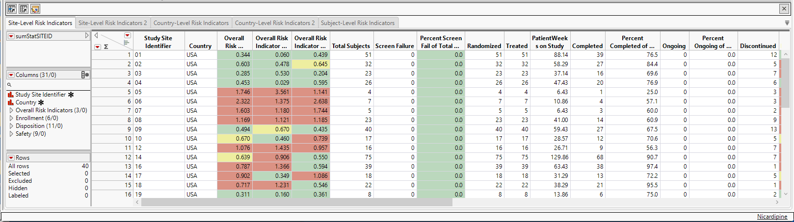

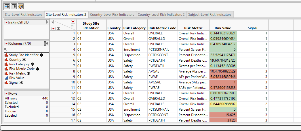

Output Data

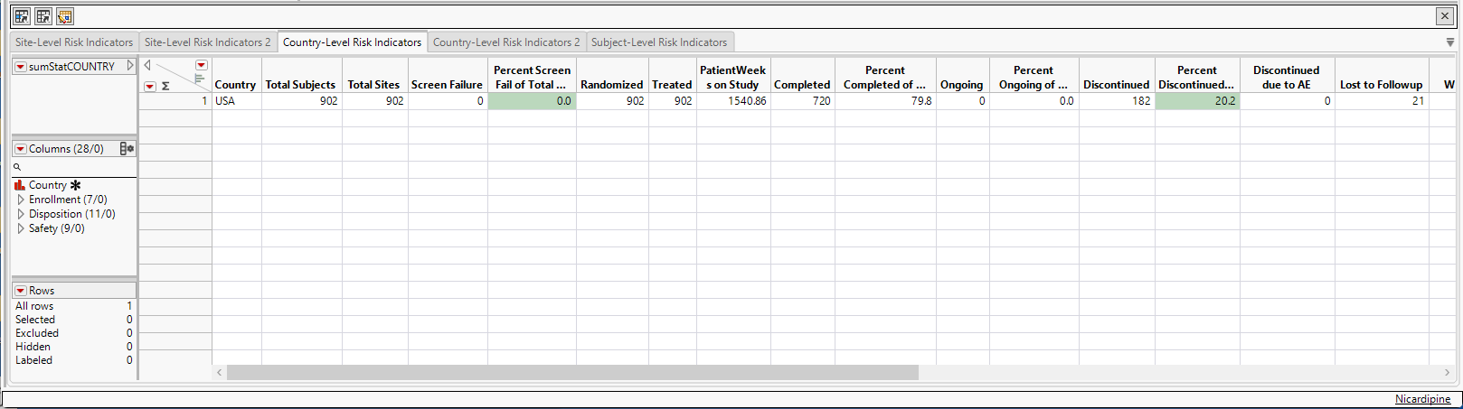

You can view the output data tables by clicking on the
action button. The data tables display risk indicators derived using the study database as well as data included in the optional supplemental data set. Two data tables are generated for each level except subject-level. The two tables at each level contain the same information, but they are organized differently.
| • | Site-Level Risk Indicators: This data table displays risk indicators summarized at the site level. Risk indicators with defined thresholds are colored in green, yellow, or red. Each site-level risk indicator is in a separate column. This is a "short" and "wide" data table. |
| • | Site-Level Risk Indicators 2: This data table displays risk indicators summarized at the site level. It contains only those risk indicators that have a defined threshold and they are colored in green, yellow, or red. All the risk values are stacked in the same column: Risk Value. The risk indicator name is stored in the Risk Metric column. This is a "long" and "narrow" data table. |
| • | Country-Level Risk Indicators: This data table displays risk indicators summarized at the country level. Risk indicators with defined thresholds are colored in green, yellow, or red. Each country-level risk indicator is in a separate column. This is a "short" and "wide" data table. |
| • | Country-Level Risk Indicators 2: This data table displays risk indicators summarized at the country level. It contains only those risk indicators that have a defined threshold and they are colored in green, yellow, or red. All the risk values are stacked in the same column: Risk Value. The risk indicator name is stored in the Risk Metric column. This is a "long" and "narrow" data table. |
| • | Subject-Level Risk Indicators |
This is the same table displayed in the Subject-Level Risk Indicators section above.
Options
Data
Use the options on this panel to customize your analysis.
Auto run this report
Check this box to auto run this report upon opening using specified study preferences
Risk Threshold Data Set
The risk threshold data set is used as a reference to identify and label levels of risk in the Study. Use the drop down menu to select the risk threshold data set to use in the analysis. Refer to Risk Threshold Data Set for more information about risk threshold data sets.
Supplemental JMP Data Table for RBM
Use this option to specify a data set containing supplemental data to include in the RBM analysis. Refer to Supplemental JMP Data Table for RBM for more information
Specify Target Enrollment
Check Specify Target Enrollment box to specify a target enrollment rate.
Target Enrollment of Subjects per Week per Site
Specify the number of subjects enrolled per week per site. Note: This option is available only when the Specify Target Enrollment box is checked.
Monitor
Check the box to perform additional analyses at the monitor level.
Vendor
Check the box to perform additional analyses at the vendor level.
Additional Filters
Disposition
This option enables you to construct a filter for selecting a subpopulation of the study based on their meeting specified Disposition criteria. Risk indicators will be calculated using this subset of dispositions only. Refer to Disposition for more information.
Adverse Events
This option enables you to construct a filter for selecting a subpopulation of the study based on their meeting specified Adverse Event criteria. Risk indicators will be calculated using this subset of adverse events only. Refer to Adverse Events for more information.
Protocol Deviations
The Protocol Deviations field is an optional parameter that enables you to filter rows from the DV data set to choose the appropriate records to deviations of interest. Click
to open the Where Clause Builder to construct the desired filter. Risk indicators will be calculated using this subset of deviations only.
Note: This filter is available only when the DV data set is included in the study.
Inclusion/Exclusion Criteria Not Met
The Inclusion/Exclusion Criteria Not Met field is an optional parameter that enables you to filter rows from the IE data set to choose the appropriate records to subset to failed inclusion or exclusion criteria of interest. Risk indicators are calculated using this subset of inclusion or exclusion criteria only. Refer to Inclusion/Exclusion Criteria Not Met for more information.
Note: This filter is available only when the IE data set is included in the study.
Healthcare Encounters
The Healthcare Encounters field is an optional parameter that enables you to filter rows from the HO data set to choose the appropriate records to subset to health-care encounters of interest. Risk indicators are then calculated using this subset of health-care encounters only. Refer to Healthcare Encounters for more information.
Note: This filter is available only when the HO data set is included in the study.
Analyze selected sites
The Analyze Selected Sites option enables you to limit the analysis to a selected subset of study sites. Risk indicators are then calculated for those sites only.
Analyze selected site categories
The Analyze selected site categories option enables you to limit the analysis to a selected subset of site categories that are specified in Site Details for Risk Based Monitoring Report.
Note: To filter subjects with a specific event or finding, one could also use the Subpopulation Builder on any domain of interest. For example, filter to all subjects that exhibit cardiac failure ( :Customized Query 01 Name == "Cardiac failure" ) and run all reports on those.
| • | Click to reset all report options to default settings. |
