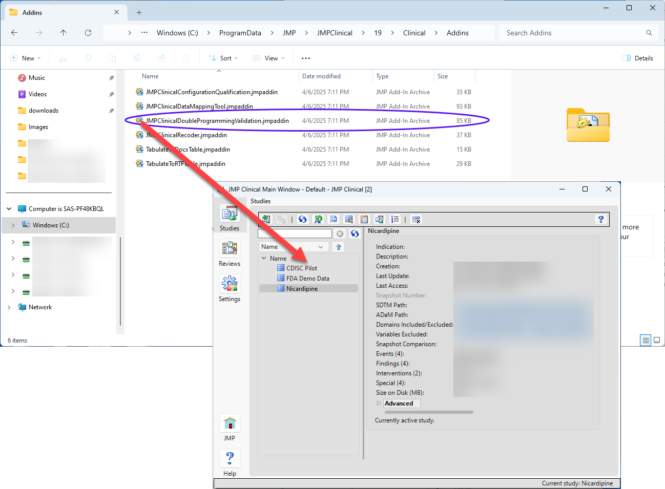

Installing the JMP Clinical Double-programming Validation Add-in
This Add-In is included in JMP Clinical. You must, however, install the add-in before you can use it.
| 8 | Navigate into Addins folder (C:\ProgramData\JMP\JMPClinical\19\Clinical\Addins). |
| 8 | Find the JMPClinicalDoubleProgrammingValidation.jmpaddin file and drag the file onto an open JMP Clinical window. |
| 8 | When prompted to install the add-in, click OK. |
The add-in installs automatically.

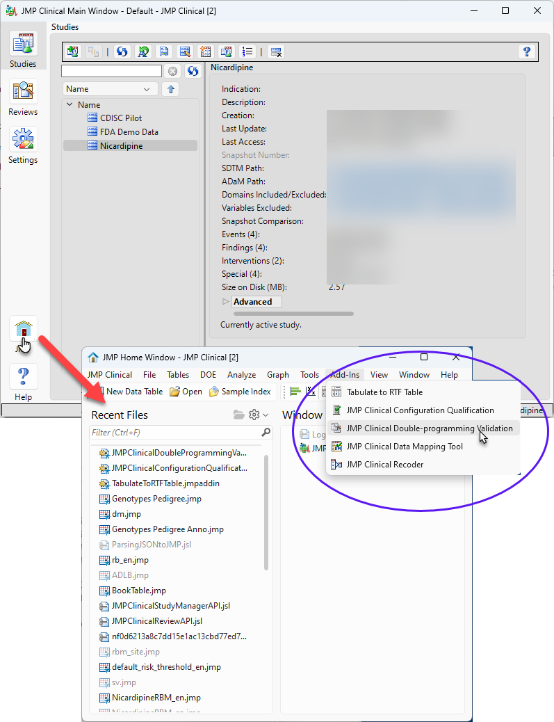

Using the JMP Clinical Double-programming Validation Tool
| 8 | To access this tool, click |
| 8 | Click Add-Ins > JMP Clinical Double-programming Validation to open the tool. |

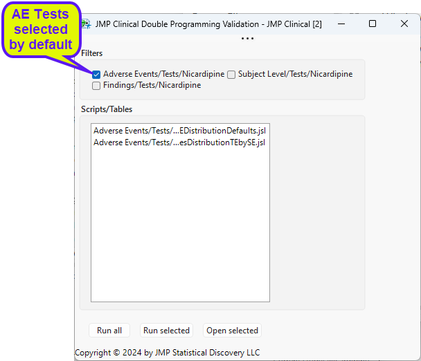

| 8 | The first two tests (Adverse Events, AE) are selected by default and listed in the Scripts/Tables pane. Checking either the Subject Level or Findings boxes selects these tests and adds them to the list in the Scripts/Tables pane. Click the appropriate check box again to select additional tests or deselect undesired tests and remove them from the Scripts/Tables pane. |
| 8 | Click to validate all of the listed tests. |
| 8 | Click on one or more listed tests and click to run only the selected subset of tests. |
| 8 | Click to open the JMP script for validating the selected test. |
| 8 | In this example, let's run just the default AE tests. Make no additional selections. Click . |

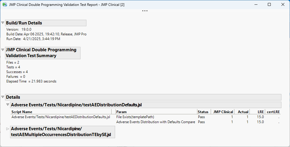

JMP Clinical Double-programing Validation Results
| 8 | Click to show the results window. |

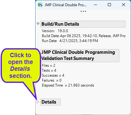

This window shows that 2 files were generated and 4 tests were run, all of which successfully validated the selected reports.
| 8 | Open the Details section. |
The details section provides more details on the tests run and their outcome.
