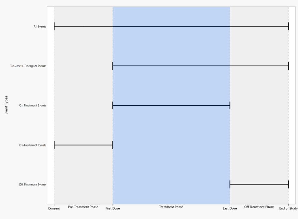

When using CDISC standards, the AE or ADAE data sets summarize the events that were experienced by patients in the study, but more information is needed. In order to conduct a recurrence analysis, dates representing the start and end of an appropriate follow-up period need to be defined for all patients, not just those who experience a particular AE. Further, the derivation of the appropriate follow-up dates will depend on the types of AEs of interest for analysis (see below).
The figure above displays start and end dates appropriate for different types of events. Dates used to define follow up period are described below, and they are considered in the order of
presentation.
Note: Visit End Date is equivalent to Visit Start Date if it is not available.
All Events include any AEs that may occur on study once informed consent is signed until the patient ends study participation.
Start date: Consent Date or Enrollment Date or Earliest Visit Start Date
End date: End of Participation or End of Study or Maximum of (Latest Visit End Date, Latest date for Disposition Events from the DS domain)
Treatment Emergent Events include any AEs that may occur on or after the first dose of study therapy determined by the treatment arm.
Start date: First Treatment Date
On Treatment Events include any AEs that may occur on or after the first dose of study therapy and before or at the last dose of study therapy.
End date: Last Treatment Date
Pre-Treatment Events include any AEs that may occur prior to the first dose of study therapy.
End date: First Treatment Date
Off Treatment Events include any AEs that may occur after the last dose of study therapy.
Start date: Last Treatment Date

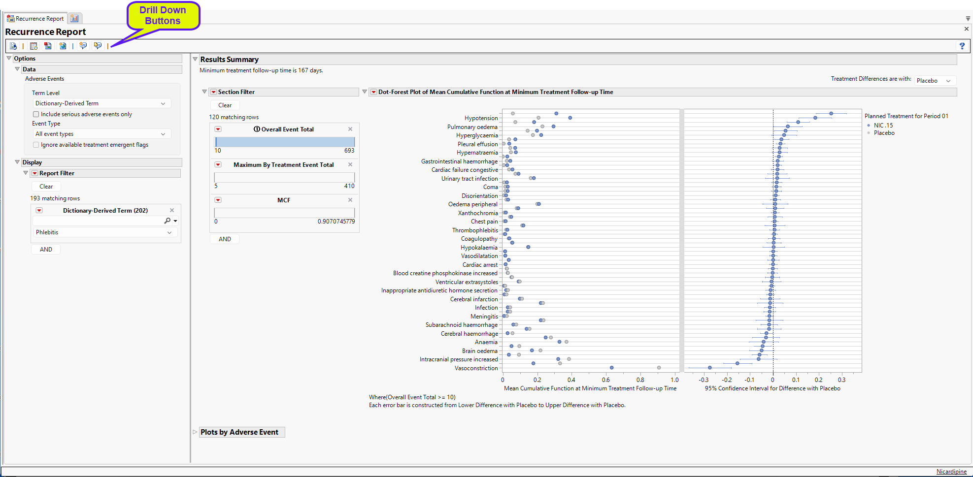

Running the Recurrence report for Nicardipine using default settings generates the report shown below. Output from the report is organized into sections. Each section contains one or more plots, data panels, data filters, or other elements that facilitate your analysis.
The Recurrence Report generates analyses for studies with one or more treatment arms and computes treatment differences between all treatments for studies with two or more treatment arms.
The Report contains the following elements:
Results Summary
For studies with two or more treatment arms, differences between the treatment arms are compared at the minimum of the maximum follow-up times for the treatments. Here, the
minimum follow-up time is 167 days.

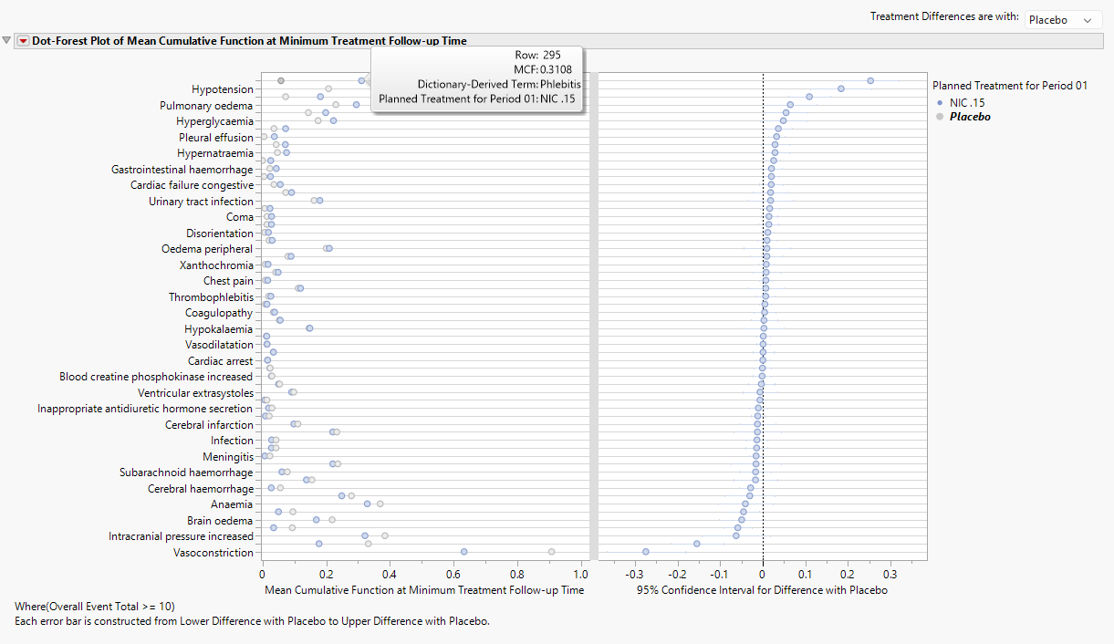

Dot-Forest Plot Summary of all AEs
The dot plot in the left panel shows the value of the Mean Cumulative Function (MCF) at 167 days while the forest plot displays the 95% confidence interval for the difference in NIC. 15 – Placebo MCFs. This difference can be reversed by altering the control arm with the combo box. From the dot plot, the MCF 0.3108 and 0.0578 for NIC. 15 and Placebo, respectively, for phlebitis. In other words, patients can expect to experience 0.3108 or 0.0578 phlebitis events by 167 days for NIC. 15 and Placebo, respectively. So, one in every 1/0.3844 = 2.6 patients will experience a phlebitis event by 17.4 days.

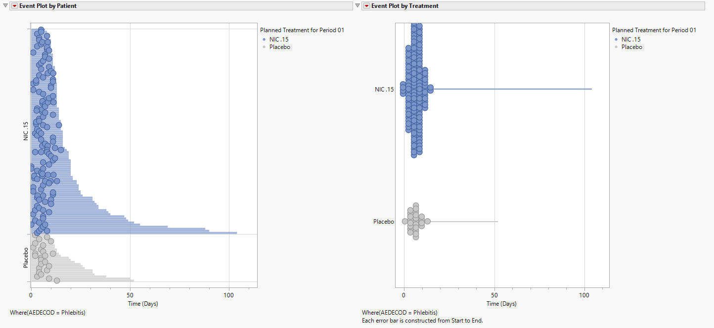

Event plots are produced to show when AEs occur across the follow-up time at the patient level (left) and treatment level (right).
Patients along the y-axis in the left hand plot are sorted according to the length of their follow-up time. The treatment-level event plot could be interpreted as the events occurring early and not beyond 13 days. However, this is due to a handful of participants with long follow-up times. As seen in the left hand plot, the phlebitis events occur pretty evenly across the follow-up time, particularly for the NIC.15 patients. Note that the bubble size is indicative of the number of events occurring at a given time. Should follow-up start and end dates not include a time component, larger bubbles would indicate multiple events occurring on a single day for a patient. This is less likely to occur when time is considered.

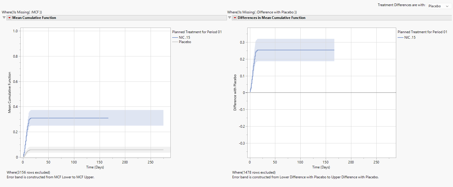

MCF Plot and Difference in MCF Plot
The left panel displays a plot of the MCF for each treatment and the pointwise 95% confidence band. The approximately straight line for the MCF (at least until about 13 days) shows that phlebitis AEs occur at a relatively constant rate over time. The MCF becomes horizontal beyond approximately 13 days indicating no additional phlebitis events occur.
Note: An MCF curve that is concave down would indicate that the time between phlebitis events is increasing, showing a decrease in phlebitis events. In other words, safety is improving for phlebitis events. An MCF curve that is concave up would indicate that the time between phlebitis events is decreasing, showing an increase in phlebitis events. In other words, safety is worsening for phlebitis events.

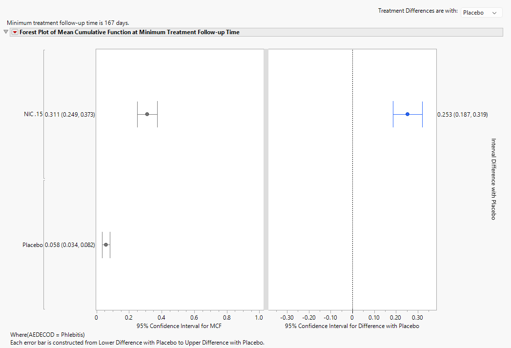

Forest Plots of MCF and Difference in MCF Confidence Intervals
The dual forest plot presents the 95% confidence intervals graphically and in text of the MCF for each treatment as well as the pairwise differences for MCF at the minimum treatment follow-up time. Like the plots shown above, the control group can be selected using the combo box. The points in the left forest plot correspond to the dot plot; here, the confidence intervals are presented to show additional information.

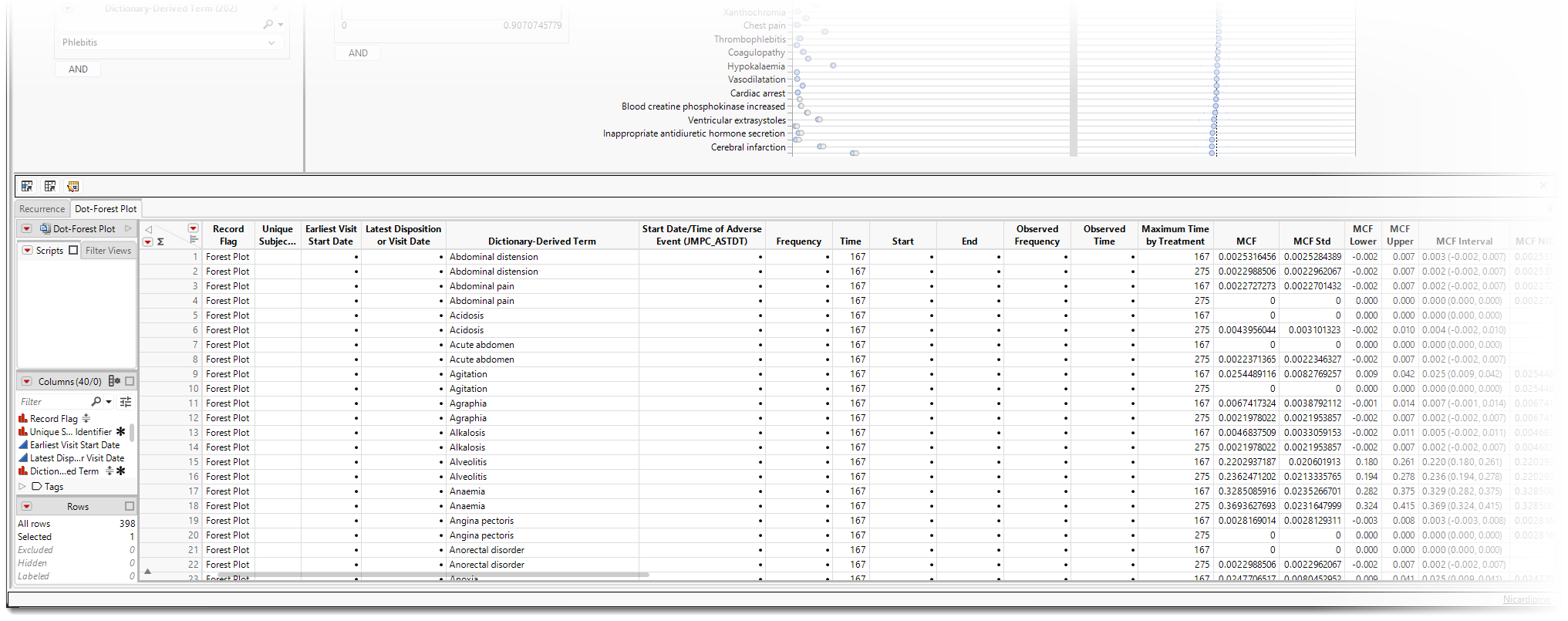

Data Tables
Finally, should additional analysis insight be of interest from the JMP Recurrence Analysis platform, the Recurrence data table where Record Flag equals Patient can be used.
8 Click to view the underlying data table.
8 Click to open the data table as a JMP table.

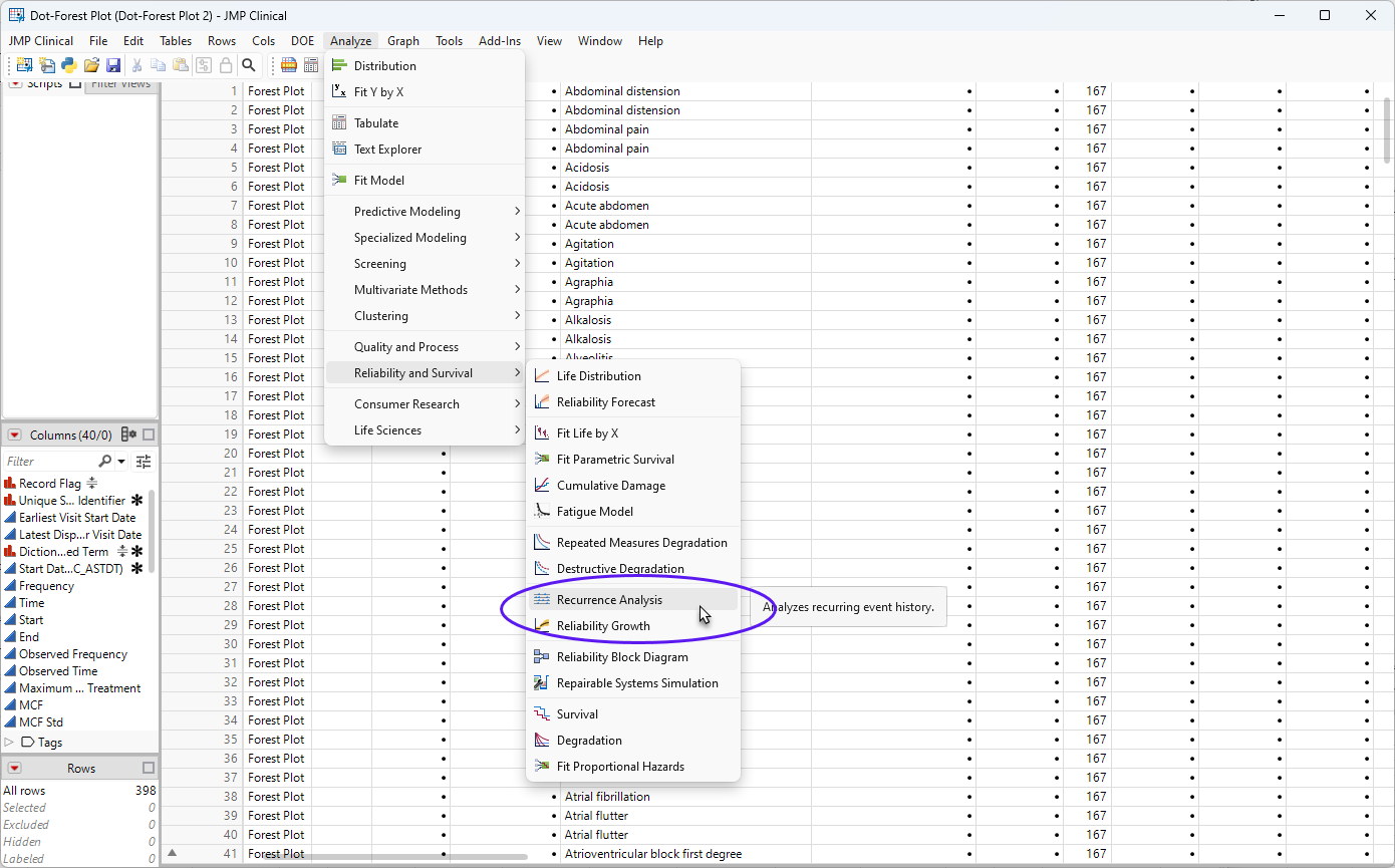

8 Select Analyze > Reliability and Survival > Recurrence Analysis to open the Recurrence Analysis platform.
8 Set the following options:
Y, Age, Event Timestamp will use the start date of the adverse event.
Label will use Unique Subject Identifier.
Cost will use Frequency.
Grouping will use Treatment.
Timestamp at Start/End will use the dates.
By will use event name, typically Dictionary-Derived Term if analyzing preferred terms.
8 Continue the analysis in JMP as described in the Recurrence Analysis platform documentation.

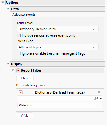

Options
Data - Adverse Events
Term Level
Term Levels are determined by the coding dictionary for the Event domain of interest, typically these levels follow the MedDRA dictionary. Use this widget to specify how each adverse event is named and the level at which the event is considered. For example, selecting Reported Term for the Adverse Event reports the event specified by the actual event term as reported in the AE domain. Refer to Term Level for more information.
Include serious adverse events only
By default, all events are included in the analysis. However, you can opt to include only those considered serious. Checking the Include serious adverse events only widget restricts the analysis to those adverse events defined as Serious under FDA guidelines.
Event Type
Analysis can consider all events or only those that emerge at specific times before, during, or after the trial period. For example, selecting On treatment events as the Event Type includes only those events that occur on or after the first dose of study drug and at or before the last dose of drug (+ the offset for end of dosing).
Ignore available treatment emergent flags
If you choose to ignore available treatment emergent flags, the analysis includes all adverse events that occur on or after day 1 of the study.
Display
Report Filter
This widget enables you to subset and view subjects based on demographic characteristics and other criteria. By default, the filter in this report enables you to filter by Dictionary-Derived Term. Refer to Data Filter for more information on filters.
