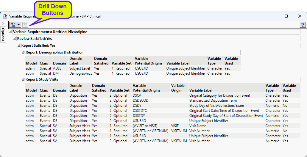

Check Variable Requirements
Clicking
in any review opens the following:
This table lists the variables required by JMP Clinical to run the specified report(s) in the review.
Drill down options include:
| • | Create static report: Click to create a PDF, RTF, HTML, Text, or JMP Journal version of the Variable Requirements table. |
| • | Create subject filter: Click to generate a subject-specific filter that can be applied to all subsequent reports run for this review. Only those subjects specified by the filter are carried through the analyses. |
