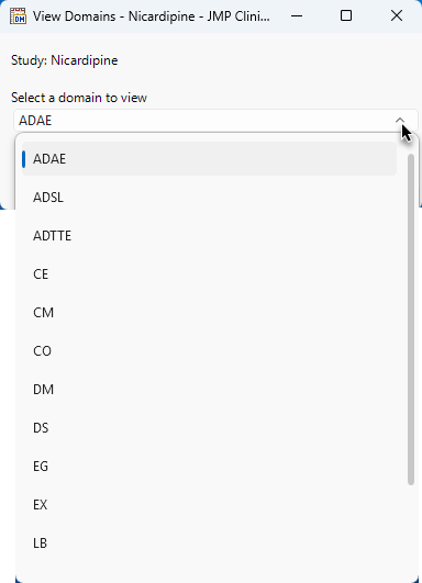

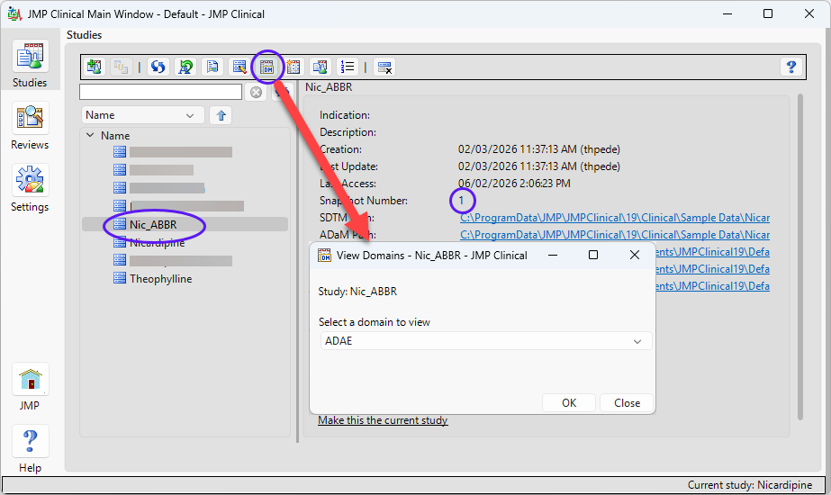

8 Open the Studies tab and highlight the Nic_ABBR study. Click to open the View Domains window.
8 Select the DM domain from the drop down menu to view the DM domain as a JMP table, as shown below.

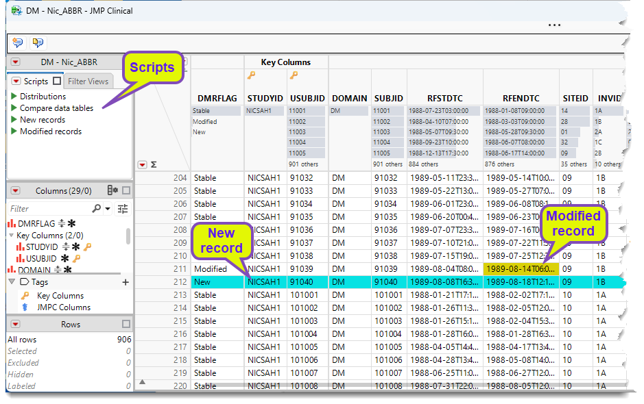

In snapshot studies, new records are highlighted in turquoise, modified records are highlighted in chartreuse, dropped records are highlighted in red, and duplicate records are highlighted in blue.

Scripts
The table contains a number of scripts that allow you to drill down into the snapshots to see how the data has changed from one snapshot to another. To run the scripts, simply click next to each script to open a subset table containing the records matching the criteria.

New Record
This script generates a subset table containing just the records that are new in the current snapshot.
Modified Records
This script generates a subset table showing how each record appeared in the previous snapshot and how it appears in the current snapshot. The values of the Snapshot Number column will identify the prior and current versions of the record.

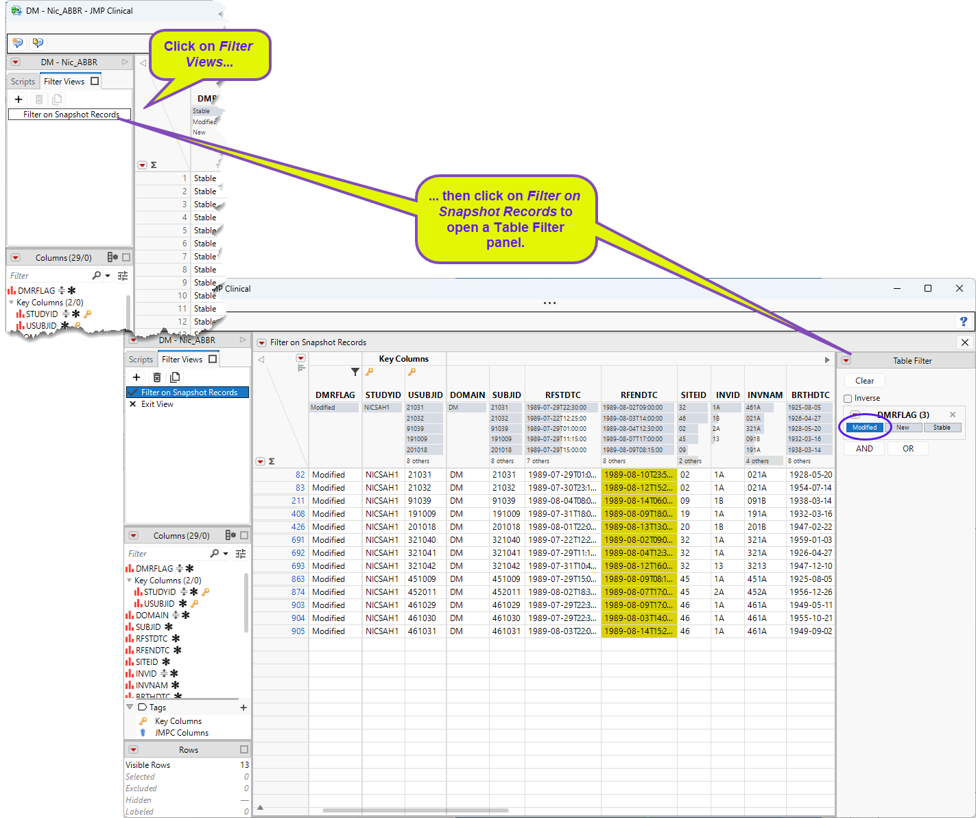

Filter Views
Filter Views allow users to filter the current data on Modified, New, and Stable records.
By default, the Modified records are selected (circled) and displayed. Click New or Stable to view those records.
