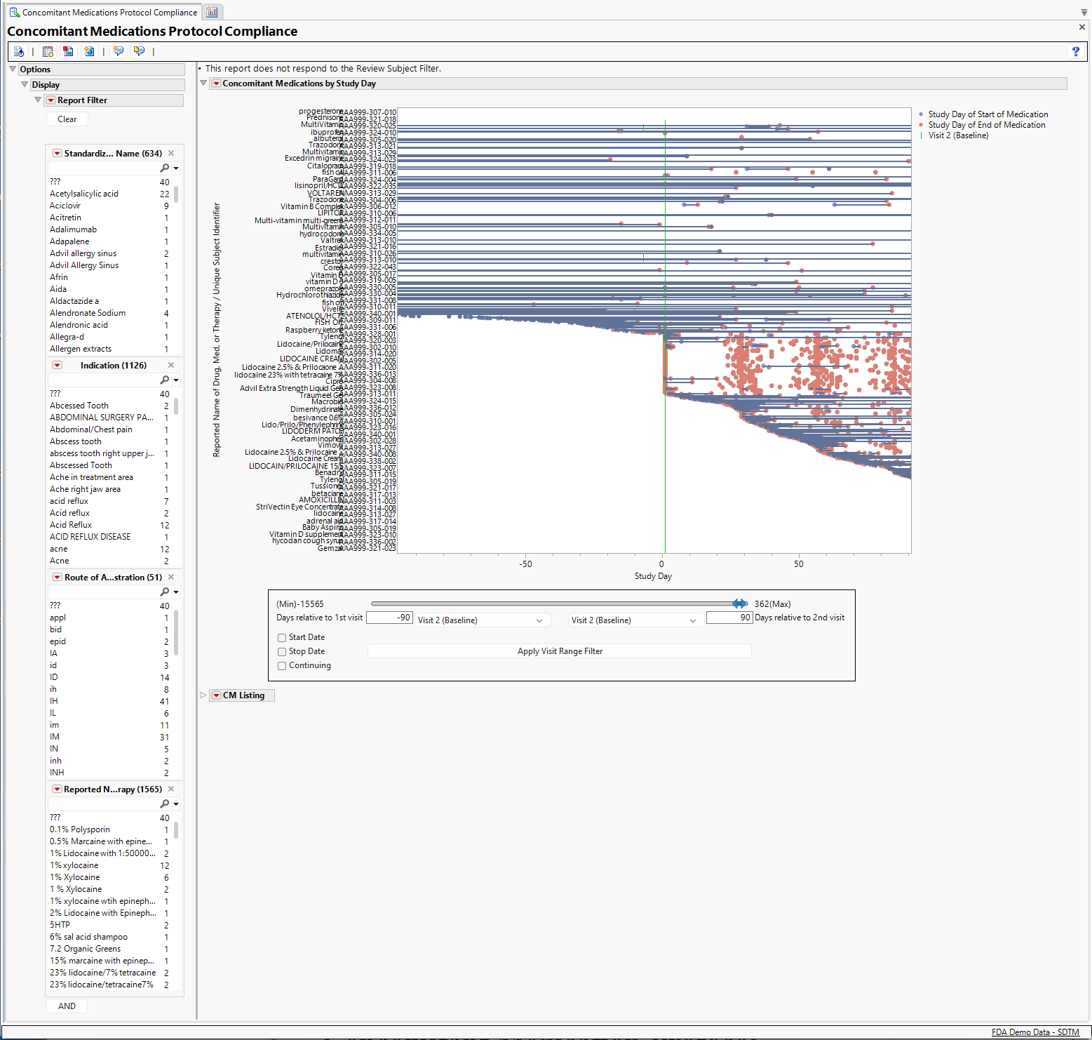

Running this report for a given studies’ Concomitant Medications (CM) and Subject Visits (SV) domains using default settings generates the report shown below.
The report contains the following elements:
Concomitant Medications by Study Day
This section includes a plot showing all of the drugs, not including the treatment under investigation, subjects received before and during the study, and the range of time they received them. Each line in the graph represents one drug received by one patient. By default, the time range displayed runs between ninety days prior to the study's baseline visit(typically Visit 2) and ninety days after that visit.

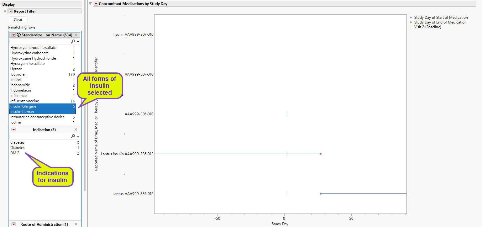

The Report Filter enables you to focus on the reported name for drugs, their class, ATC Code or indications for identifying specific subjects for exclusion. For example, suppose that the trial design required that subjects taking insulin within 90 days before or after the baseline visit were to be excluded from the study. By selecting insulin in the medication list, we discover that three subjects were identified as having taken insulin.
One subject received insulin throughout the study period, switching between forms between days 20 and 30.

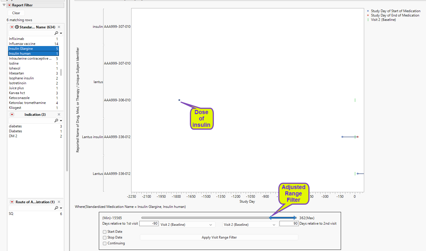

The other two subjects were flagged even though they showed no reported use of insulin during the study period. In these cases, insulin use occurred and ended long before the beginning of the study. For example, using the Visit Range Filter, we see that one subject reported the last insulin use occurred ~1800 days prior to the start of the study.

Visit Range Filter
The Visit Range Filter enables you to set the time window for screening for concomitant medication compliance. Use the slider to extend or contract the window. Set specific visits, start and end dates (relative to specified visits) and continuing for the medications (within the selected visit range). Once the range settings have been specified, click to apply the changes. Once clicked, changes to . Click to reset the Visit Range Filter.
Changing any selections within the Visit Range Filter will clear the previous visit range filter. For the new selections to be applied, click .
Note: Any medications missing an end date are considered to be continuing.

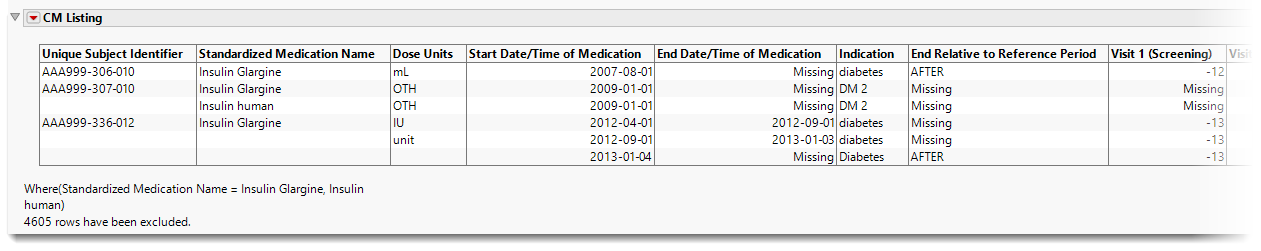

CM Listing
This interactive table lists all the concomitant medications reported by all of the subjects, with start and end dates (both absolute and relative to the reference period), dosages, and indications. The study day of each visit is also listed. This table is responsive to the report filter, showing only the subjects and medications meeting the filter criteria.
The table contains the following columns, by default:
| • | Unique Subject Identifier |
| • | Reference ID |
| • | Reported Name of Drug, Med, or Therapy |
| • | Standardized Medication Name |
| • | Total Daily Dose |
| • | Dose Units |
| • | Dose per Administration |
| • | Start Date/Time of Medication |
| • | End Date/Time of Medication |
| • | Category for Medication |
| • | Subcategory for Medication |
| • | Indication |
| • | Medication Class |
| • | Epoch |
| • | Visit Name |
Note: Study day 1 is determined by the study dates and/or study days for the baseline visit (usually Visit 2).
