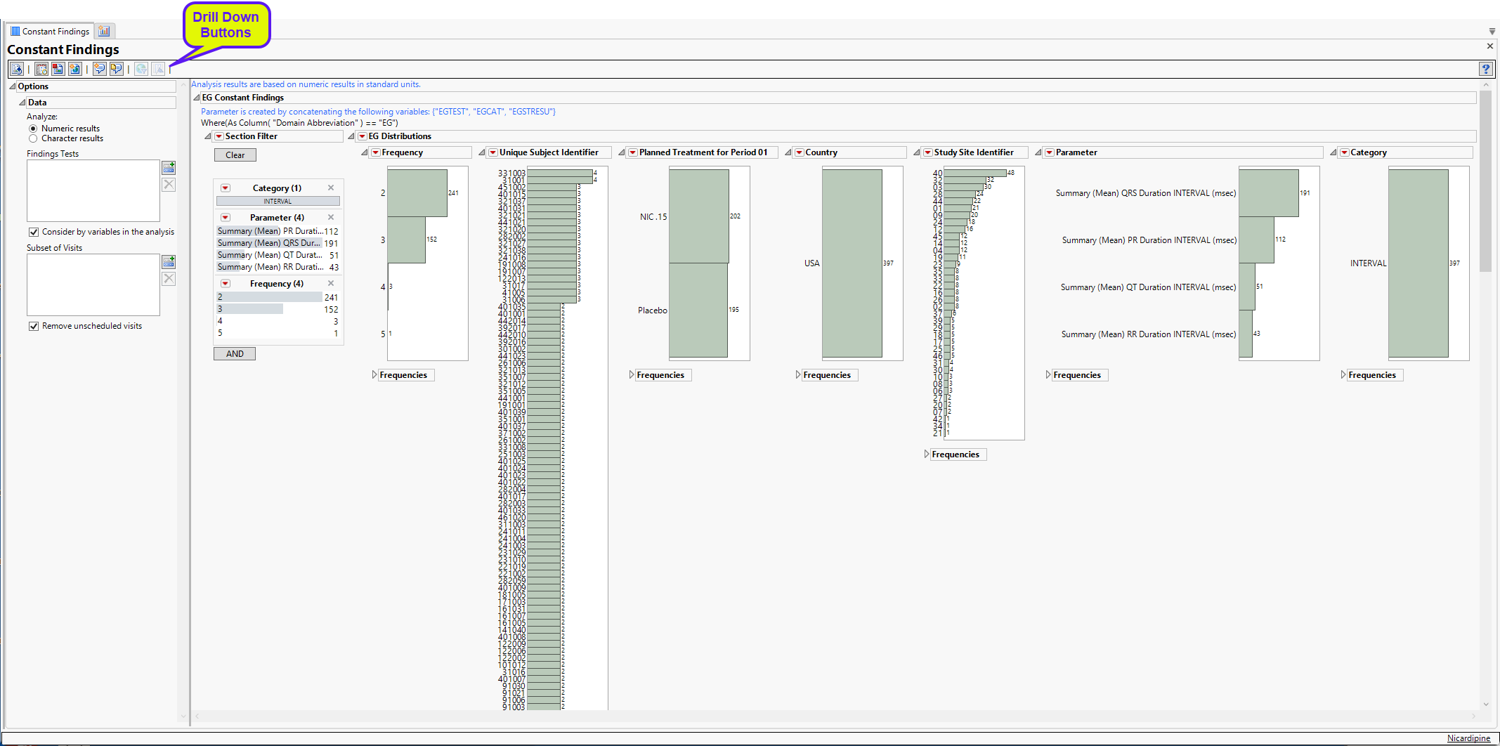

Running Constant Findings for Nicardipine using default settings generates the report shown below.
The Report contains the following elements:
Test Results
Multiple sections, one for each findings domain, are displayed. Data that are summarized are those test codes that are constant throughout the course of the study.
Each section contains the following elements:
| • | One or more Histograms. |
The data table underlying these histograms represent tests that are constant for the duration of the trial. Therefore, Unique Subject Identifier summarizes the number of parameters that are constant for each subject. Study Site Identifier shows the frequency of constant tests at each study site. Country summarizes the country of the study site subjects participated at. Test or Examination Name shows the tests that are constant. Treatment Arm is provided to show whether the frequency of constant tests varies based on study treatment.
See Distribution for more information.
Click the
general button to show the records for selected subjects. This details the tests that are constant, as well as the value and the number of times each value is repeated.

These filters enable you to subset and view subjects based on demographic characteristics and other criteria. The default filter in this report enables you to select the findings results you want to view. Refer to Data Filter for more information.
| • | Frequency Tables |
There is a table for each bar chart listing the frequencies and probabilities for observing constant findings.
