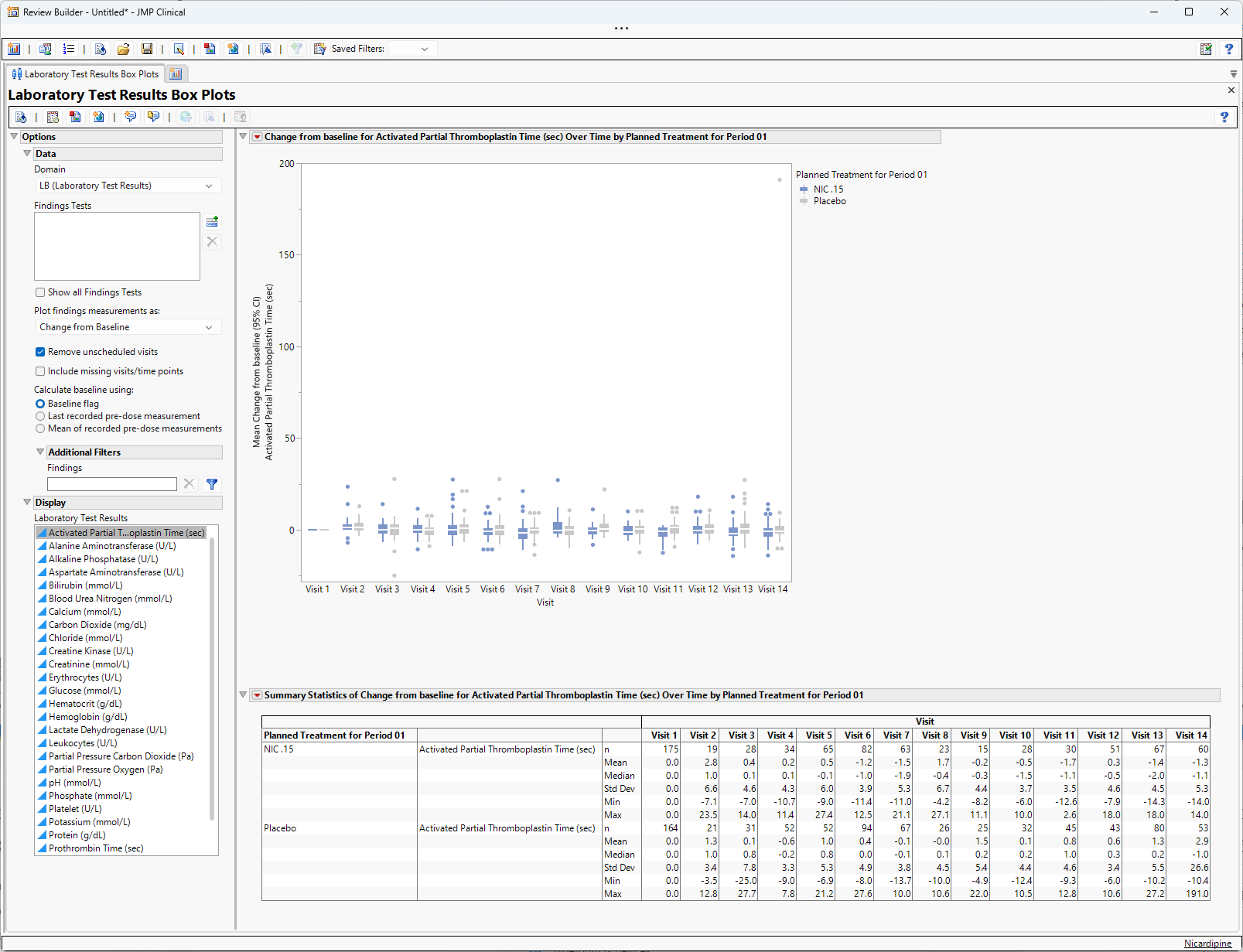

Running Findings Box Plots for Nicardipine using default settings generates the report shown above. Output from the report is organized into sections. Each section contains one or more plots, data panels, data filters, or other elements that facilitate your analysis.
Box Plots display values chosen in the Plot findings measurements as: option. Findings results (LB, VS, or EG) displayed depend on the domain selected using the Domain option. Use the column switcher to the left of the plots to select the findings test results to display.
Each box plot set represents an xxTESTCD from the selected domain. For example, in the graph above, the first figure represents the change from baseline for APTT (Activated Partial Thromboplastin Time) at each visit for both treatment arms. The table presents the associated statistics.
You may notice a difference in baseline vital signs results between JMP Clinical v8.1 and v19. This can happen when the baseline calculation is for the mean of recorded predose measurements for findings that have "Y" as a value for VSBLFL if some of those rows are missing a value for VSDY. v8.1 computes the mean for all rows that have a value of "Y" as a value for VSBLFL, regardless of the value of VSDY. v19 ignores any rows lacking a value for VSDY and computes baseline means using just the rows that both have a value of "Y" as a value for VSBLFL, and some value for VSDY.
A table summarizing the statistics of the specified finding(s) from baseline across visits is shown at the bottom of the report. In this table, n represents the number of subjects at each visit.

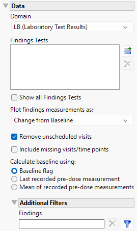

Data
Domain
Use this widget to specify whether to plot the distribution of measurements from either the Electrocardiogram (EG), Laboratory (LB), or Vital Signs (VS) findings domains.
Findings Tests
Use this widget to select specific Findings tests.
| 8 | Click to open the Add window (shown below) that lists available test names (shown below). |
| 8 | Select the desired test(s) and click to add them to the text box. |
Show all Findings Tests
Checking this box will show all the graphs for every findings test instead of one graph with a column switcher.
Use this widget to specify whether to plot the results either as observed or how they relate to the baseline measurement. Refer to Plot findings measurements as: for more information.
Remove unscheduled visits
You might or might not want to include unscheduled visits when you are analyzing findings by visit. Check the Remove unscheduled visits to exclude unscheduled visits.
Include missing visits/time points
Check the box to include missing visits/time points in both the box plot and the summary table.
Calculate baseline using:
Use the widget to specify how the baseline is to be calculated. Refer to Calculate baseline using: for more information.

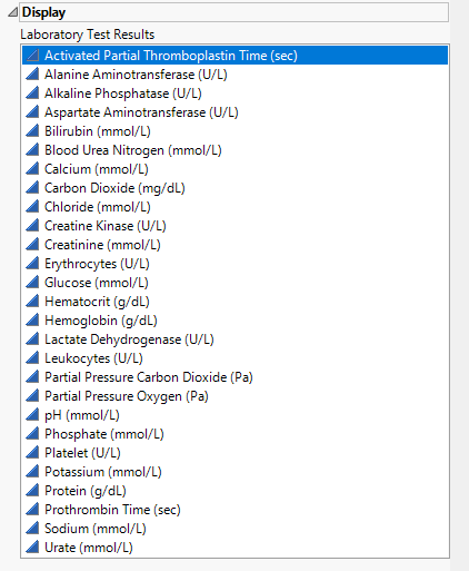

Laboratory Test Results
Highlight the Findings test you want to display.
