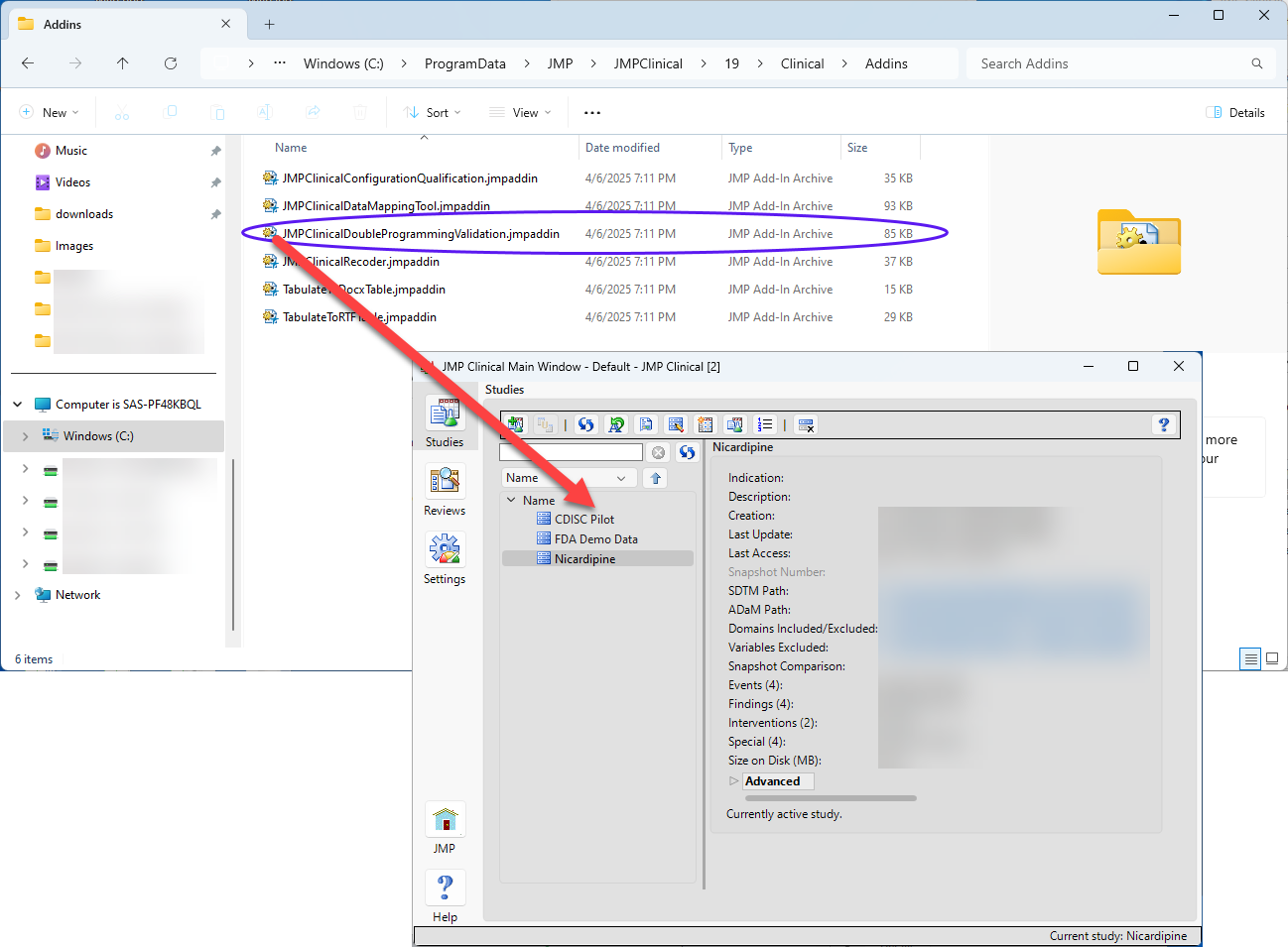

This Add-In is included in JMP Clinical. You must, however, install the add-in before you can use it.
8 Navigate into Addins folder (C:\ProgramData\JMP\JMPClinical\19\Clinical\Addins).
8 Find the JMPClinicalDoubleProgrammingValidation.jmpaddin file and drag the file onto an open JMP Clinical window.
8 When prompted to install the add-in, click OK.
The add-in installs automatically.

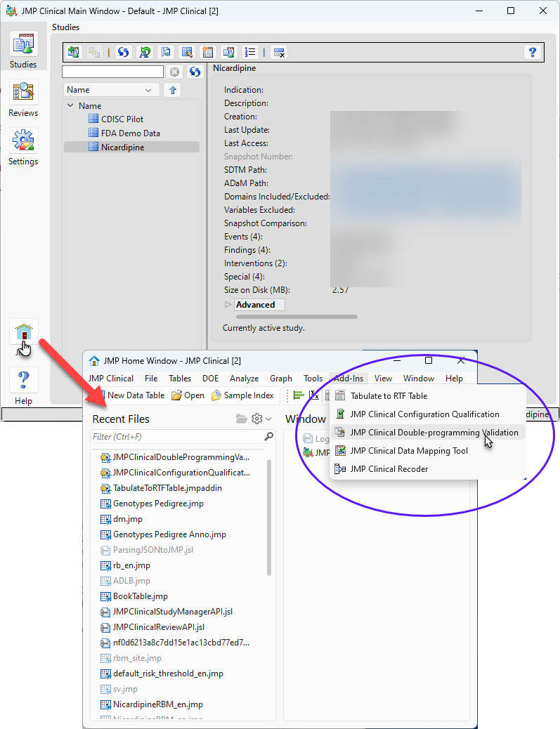

8 To access this tool, click on the JMP Clinical Main Window to open the JMP Home Window.
8 Click Add-Ins > JMP Clinical Double-programming Validation to open the tool.

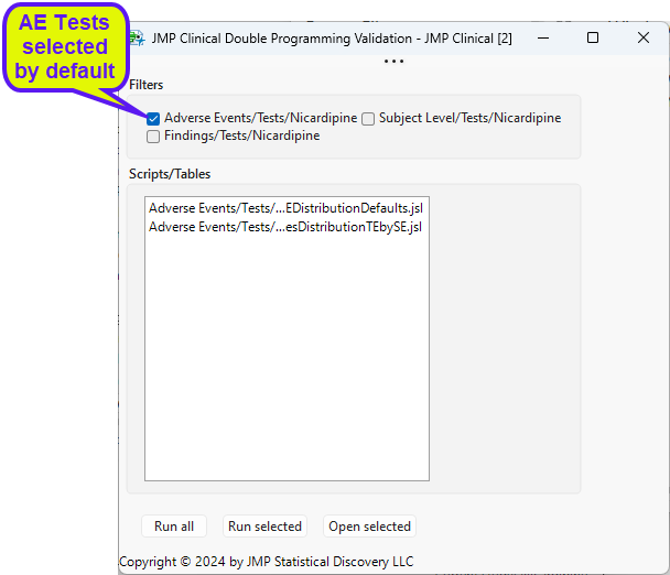

8 The first two tests (Adverse Events, AE) are selected by default and listed in the Scripts/Tables pane. Checking either the Subject Level or Findings boxes selects these tests and adds them to the list in the Scripts/Tables pane. Click the appropriate check box again to select additional tests or deselect undesired tests and remove them from the Scripts/Tables pane.
8 Click to validate all of the listed tests.
8 Click on one or more listed tests and click to run only the selected subset of tests.
8 Click to open the JMP script for validating the selected test.
8 In this example, let's run just the default AE tests. Make no additional selections. Click .

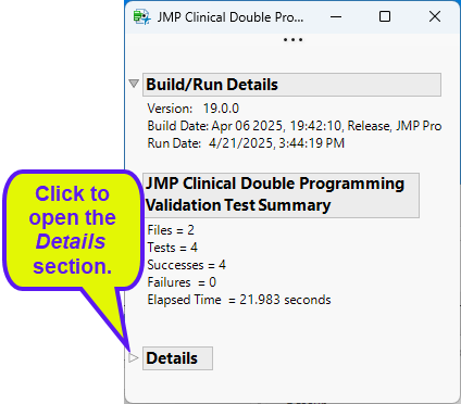

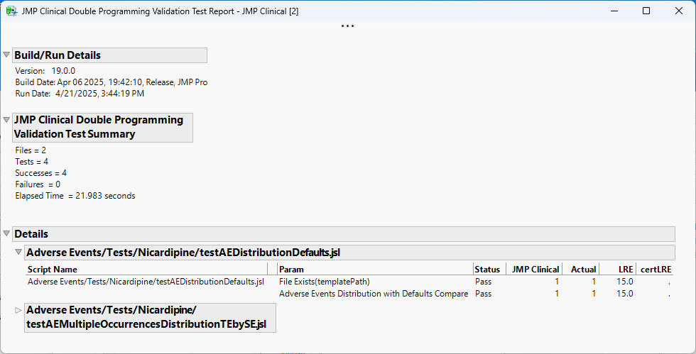

This window shows that 2 files were generated and 4 tests were run, all of which successfully validated the selected reports.
8 Open the Details section.
The details section provides more details on the tests run and their outcome.
