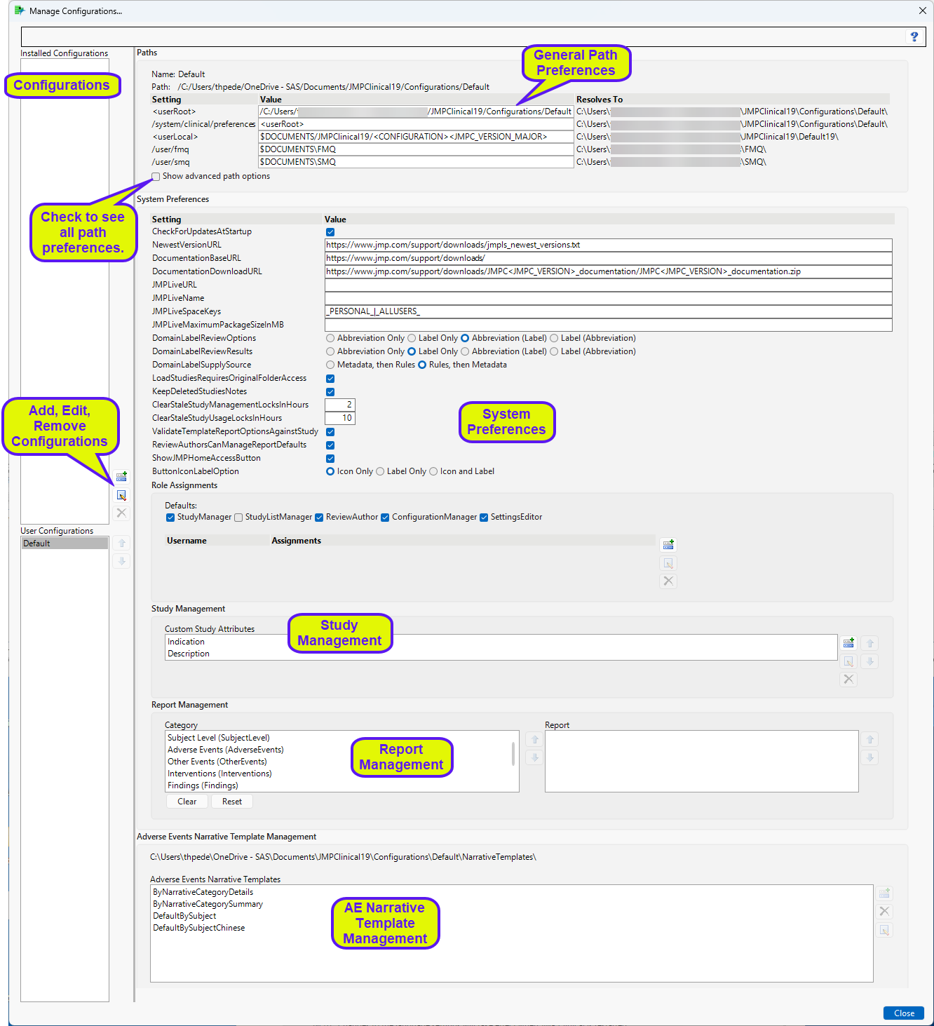

Manage Configurations
The Manage Configurations... window is accessed from the Settings tab of the JMP Clinical Main Window.
8 Click to open the Manage Configurations... window, shown below:

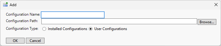

8 Click to open the Add window shown below:
8 Specify a name for your configuration.
In this case, the configuration is named Share.

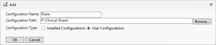

8 Click to open a Choose Directory window.
8 Navigate into the Clinical Share folder and click .
8 Click the User Configurations radio button.
The Add window appears as shown below:
8 Click .

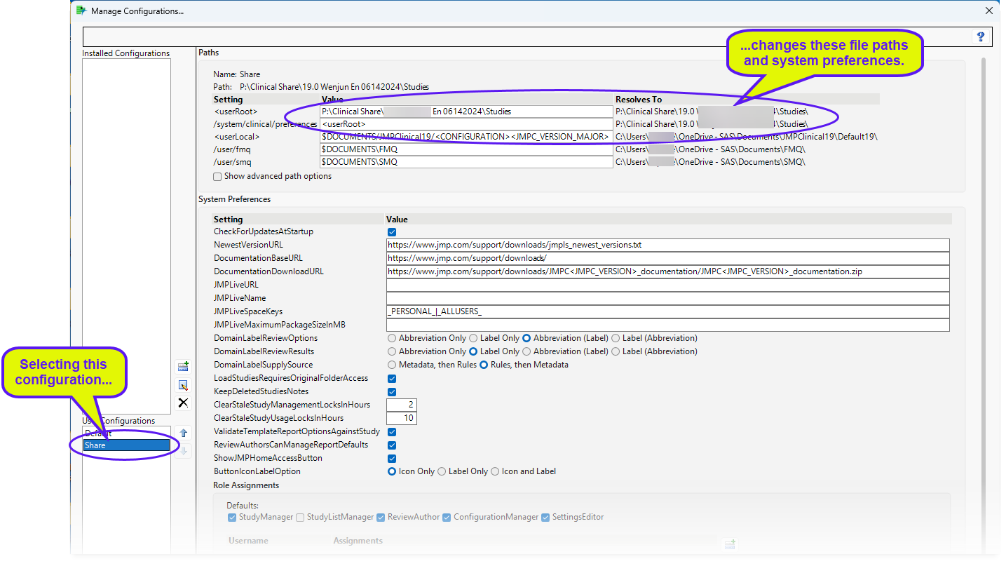

The new configuration is added to the Manage Configurations window. If you select it, all of the default paths and system preferences are displayed, as shown below:
Note: While all paths and preferences are editable, you should consult your system administrator before making any changes.
8 Click to close the Manage Configurations window.
Note: Anyone with Read and Write privileges on the shared drive has access to a new shared folder. As the creator of this folder you can control level of access by changing the permissions using WinOS commands.

/*** Comment about preference group ***/
{“PreferenceKey”, PreferenceValue},
Note the optional comment enclosed by /*** ***/, the left, and right braces ({}) enclosing the key-value pair, the key enclosed in double quotation marks (“”), the comma (,) after the key, the value (the presence of enclosing quotation marks or braces varies depending on its type), and the comma following the enclosed key-value pair unless it is the final key-value pair in the file.
Documentation
Key
Description
URL
DocumentationBaseURL
Specifies the URL containing the online JMP Clinical documentation. http://www.jmp.com/support/downloads/
DocumentationDownloadURL
Specifies the URL from which to download documentation.
http://www.jmp.com/support/downloads/JMPC<version>_documentation/JMPC<version>_documentation.zip
JMP Live
Key
Description
URL
JMPLiveURL URL to the JMP Live instance you are publishing to. To be determined by your system administrator.
JMPLiveName
Name of the JMP Live instance Not applicable
JMPLiveSpaceKeys Keys of the JMP Live Spaces available to the current user. Not applicable
JMPLiveMaximumPackageSizeInMB The maximum size of a JMP Live package. Set by your system administrator Not Applicable.
Labeling
Key
Description
Options
DomainLabelReviewOptions
Specifies how domains are identified on the report options.
Abbreviation Only: Defines a domain on the report dialog and all options by its abbreviation only. For example, the Laboratory Test Results domain is defined as LB.
Label Only: Defines a domain on the report options by its label only. The label displayed is the version specified using the DomainLabelSupplySource option. For example, the LB domain is defined as Laboratory Test Results.
Abbreviation (Label): Defines a domain on the report options by both its label and its abbreviation. For example, the Laboratory Test Results domain is defined as Laboratory Test Results (LB).
Label (Abbreviation): Defines a domain on the report options by both its abbreviation and its label. For example, the Laboratory Test Results domain is defined as LB (Laboratory Test Results)
DomainLabelReviewResults
Specifies how domains are identified on the report results, graphics, and tables.
Abbreviation Only: Defines a domain on the report results by its abbreviation only. For example, the Laboratory Test Results domain is defined as LB.
Label Only: Defines a domain on the report results by its label only. For example, the LB domain is defined as Laboratory Test Results.
Abbreviation (Label): Defines a domain on the report results by both its label and its abbreviation. For example, the Laboratory Test Results domain is defined as Laboratory Test Results (LB).
Label (Abbreviation): Defines a domain on the report results by both its abbreviation and its label. For example, the Laboratory Test Results domain is defined as LB (Laboratory Test Results)
Specifies which label to preferentially display in report options and results: the one found in the study metadata or the one specified by CDISC rules.
Metadata, then rules: When this option is selected, JMP Clinical first attempts to find and use labels in the study metadata file. It then assigns a label, based on CDISC rules, for any domain missing a label in metadata.
Rules, then metadata: When this option is selected, JMP Clinical assigns labels based on CDISC rules. For custom domains, for which CDISC rules are not available, JMP Clinical uses labels found in metadata
Study Management Options
Key
Description
Options
LoadStudiesRequiresOriginalFolderAccess
Verifies that the user has permitted access to the original study data.
Note: JMP Clinical does nothing to subvert permissions.
Checked - When JMP Clinical is launched and studies are reloaded, the user will not see those studies for which the original study data has either been deleted or have had read access permissions revoked.
Unchecked - Users will see all studies previously added so long as the metadata is available.
LazyLoadStudies
Specifies when to load the metadata for one or more studies.
Checked - Loads metadata when an operation is performed on a selected study.
Unchecked - Loads the metadata for all studies when you launch JMP Clinical
KeepDeletedStudiesNotes
Specifies whether to retain the notes associated with studies that you delete.
Checked - When a study is deleted, do not delete notes associated with it. Choose this option to preserve study artifacts when you do not anticipate using the same study name in the future.
Unchecked - When a study is deleted, delete notes associated with it.
Lock File Options
Key
Description
Supported values
ClearStaleStudyManagementLocksInHours
Specifies the amount of time, in hours, to wait before offering users the option to clear a study management lock.
A study management lock is a temporary restriction imposed on users to prevent conflict with an ongoing study management operation (for example, adding, combining, refreshing, renaming, and deleting studies). Under normal circumstances, these locks are removed automatically when the study management operation is complete. Operations on very large studies generally take more time. Exceptional system events might prevent the operation from completing, keeping the lock in effect.
Lower the value of this option to give users greater freedom to forcibly remove an outstanding study management lock set by another user.
0...1e+308, with fractional hours permissible.
ClearStaleStudyUsageLocksInHours
Specifies the amount of time, in hours, to wait before offering users the option to clear a study usage lock.
A study usage lock is a temporary restriction imposed on users to prevent conflict with an ongoing study usage operation (for example,, running reports in Review Builder). Under normal circumstances, these locks are removed automatically when the study usage operation is complete. A user leaving Review Builder open, as well as exceptional system events, might keep the lock in effect.
Lower the value of this option to give users greater freedom to forcibly remove an outstanding study usage lock set by another user.
Review Options
Key
Description
Options
ValidateTemplateReportOptionsAgainstStudy
Specifies whether to show a warning if the options specified in a review template are not available for the current study.
Checked - Show a detailed warning notification if the review template specifies options that are not available for the current study. Offending and replacement values are shown, and offending values are replaced as needed.
Unchecked - Do not show a warning notification if the review template specifies options that are not available for the current study. Offending values are replaced as needed.
ReviewAuthorsCanMangeReportDefaults
Enables the Review Author to save what the defaults are for each Report.
Checked - Adds the icon to the options bar for each report. Checked by default. Options include:
Save current options as defaults: Report uses and saves the options that are currently set and reuse those options whenever that report is added to the Review.
Reload saved options defaults: Loads the currently saved options. This is useful if an author has added the Report to the Review, made changes to the options, and then wants to return to whatever was previously saved.
Clear and reset factory defaults: Deletes the saved options for the current Report and reloads the factory defaults.
Unchecked - Options listed above are not available
ShowJMPHomeAccessButton
Specifies whether to make the JMP button available on the JMP Clinical Main . This button surfaces the JMP Home , which allows easy access to core, non-Clinical specific, JMP functionality.
Checked - The JMP access button appears on the JMP Clinical Main .
Unchecked - The JMP access button does not appear on the JMP Clinical Main Window.
ButtonIconLabelOption
Specifies how to label reports in Review Builder.
Icon Only: Label report tabs with an icon only. This is the most compact labeling option.
Label Only- Label report tabs with a text label only. This takes up more horizontal space than an icon.
Icon and label - Label report tabs with both an icon and a text label. This is the least compact labeling option.
Role Assignments
By default, a JMP Clinical installation is fully functional with all reports and options available to you. However, the JMP Clinical installed on your machine, might be configured for a specific user role. These roles are set as described in Adding Users and Specifying Role Assignments.
What follows here is a brief description of each of the JMP Clinical user roles and how to specify roles for each user.
Study Manager
A user with this role can do all of the operations involved in managing studies within JMP Clinical: add, combine, and refresh metadata, rename or move folders, update a review with a new snapshot, update the study risk data set, and delete studies.
Study List Manager
A user with this role can do everything that a Study Manager can do. In addition, a user with this role can remove studies from shared locations. This option is not enabled, by default.
This option is important in the following scenario: a user completes an analysis of a study, deletes the study from the local install of JMP Clinical, and then deletes the study data files from a shared location. Unfortunately, this process does not delete the study name from the shared metadata file. It still appears in other users’ JMP Clinical installations but cannot be accessed. The study name also remains unavailable and cannot be used again. A Study List Manager can remove the study by the following:
8 Click the Studies tab.
8 Click the Name drop-down menu and select Unlisted (no access).
8 Highlight the study to be deleted and click .
Review Author
A user with this role can create/edit/save Review Templates, do ad hoc analyses, and create and save Reviews. They can also manage the Risk Threshold data sets used by the configuration. A Review Author implicitly has the Reviewer role as well.
Configuration Manager
A user with this role can create/edit/save configurations. alterable features include file paths, system preferences, role assignments, and order of report sections.
Settings Editor
This role is normally found in conjunction with one or more of the other user roles. A user with this role has access to the Settings tab on the Main Clinical window. This enables them to select different configurations (if defined), change how they view Documentation and Help, and download and install a local copy of the documentation.
Note: The JMP Clinical Main Window will change depending on the user's role assignment. Refer to The JMP Clinical Main Window Changes Depending on the Assigned User Role. for more information.
Use the Role Assignments options to define roles for additional users,
Note: The ability to define both the domain and user gives the system administrator flexibility in identifying individual users. For example, CARYNT\sasajf actually designates both the user name (sasajf) and the network domain (CARYNT) to which the user belongs.
To add a user:
8 Click to open the Add window.
8 Enter the user’s domain (if needed) and Windows user name in the text box.
8 By default, the new user has all of the roles checked under Defaults.
8 Check the appropriate boxes to Grant the new user a role not already checked in Defaults.
8 Check the appropriate boxes to Revoke from the new user a role that is checked in Defaults.
8 Click to add the user.
To edit a user’s role assignments:
8 Select an existing user.
8 Click to open the Edit window.
8 Check the appropriate boxes to Grant the user one or more additional roles.
8 Check the appropriate boxes to Revoke from the user one or more assigned roles.
8 Click to save the changes.
To delete a user:
8 Click to delete the user.
Report Management
The Report Management option enables you to specify the order in which the report categories and the reports themselves are presented in the review.
Adverse Events Narrative Template Management
The Adverse Events Narrative Template Management option enables users to add/remove selected templates that are available for the selected configuration. Configurations shared among users are immediately impacted by changes made to the list of available templates.
The Adverse Events Narrative Templates section lists all of the templates currently in the selected configuration. The templates are listed by their names (name of the base VM file) and the date/time of the last modification. You can add, remove, or edit templates using the action buttons.
The button is enabled if there are templates that are in the JMPC installation location (as per the installation.path.preferences file) that are NOT in the configuration's template location (also per the the installation.path.preferences). Note that existence is based on name and modification date/time. That is, a template may appear to be in the configuration and the install (have the same name), but if the modification date/times don't match, it is available for adding. In the cases where there isn't a match between the configuration and installation, the template is marked with a trailing asterisk (*).
The button is used to remove a template from the configuration. In the cases where these isn't a template match, a warning is issued that the selected template cannot be recovered once deleted. This is to handle the cases where a configuration has templates that were added outside of the installation.
Finally, the button attempts to launch (open) the .VM files that comprise the selected template. This is simply delegating the edit action to the OS. The editing program selected depends on you machine's operating system preferences.
