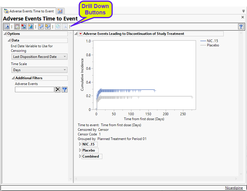

Adverse Events Time to Event
Adverse Events Time to Event generates analyses for studies with one or more treatment arms and computes treatment differences between all treatments for studies with two or more treatment arms.
Most analyses of adverse events (AEs) compare the proportion of patients experiencing an AE across treatments. This analysis is limited in that it does not consider the time at which an event occurs. For example, two treatments could have the same number of patients experiencing events, but the patients on one treatment could experience their events much earlier than the other treatment. Experiencing an event early implies that there is ample opportunity to experience the event additional times over the course of follow up.
This analysis does not consider each and every AE experienced by the patient (see the Adverse Events Recurrence for this type of analysis), only the first experienced. For each type of AE, the analysis computes the time until the first event for patients experiencing the event. Patients who do not experience the event are censored at their last available follow-up.
