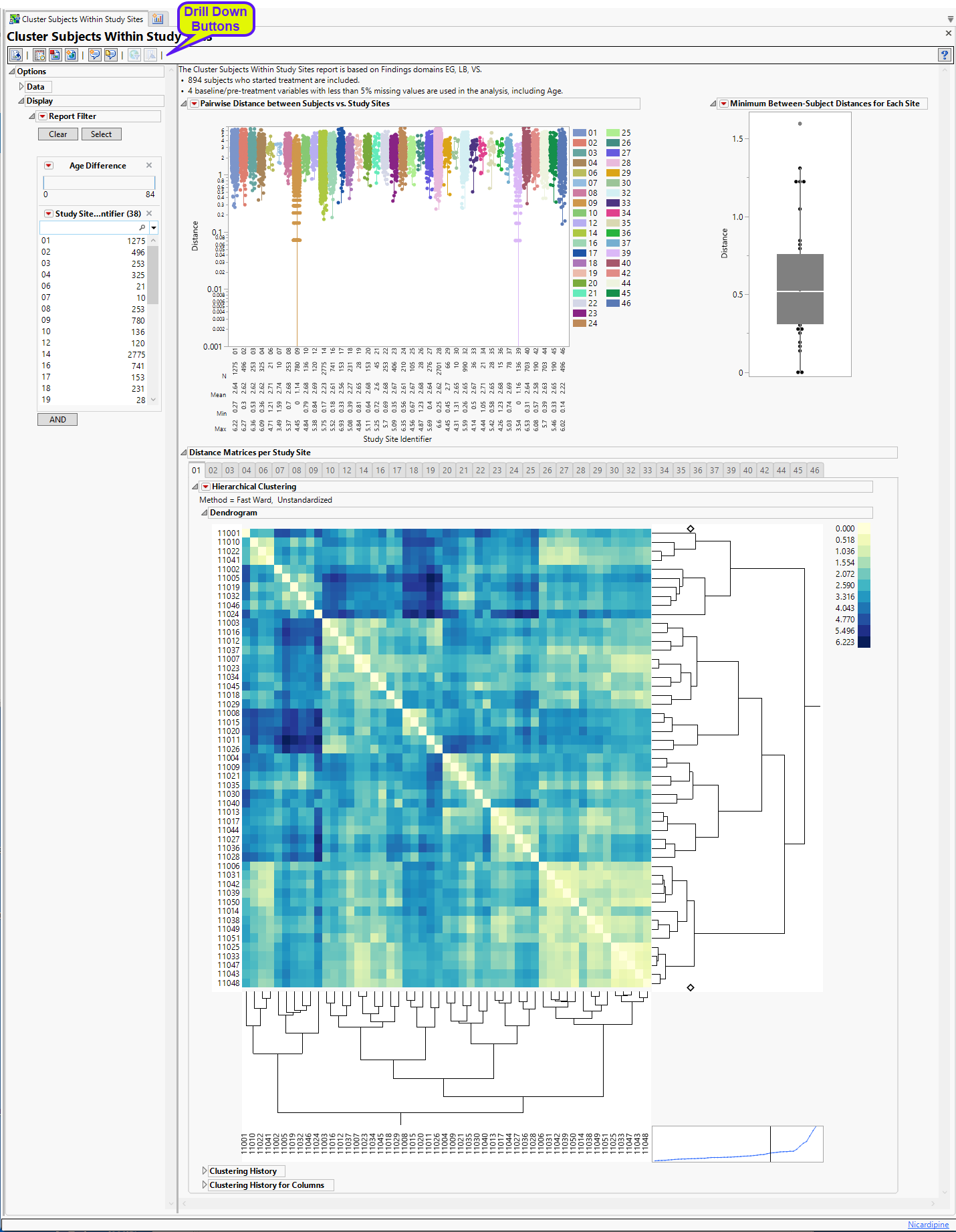

Running this report for Nicardipine using default settings generates the report shown below.
The Cluster Subjects Within Study Sites report shows the results of clustering of the subjects on the basis of different study sites. The results for each grouping are presented in a separate “section”.
Note: Some subgroups may not appear in the report because they were excluded from clustering — for example, due to only one subject or missing data for that subgroup. See the log for a full explanation of any excluded subgroups.

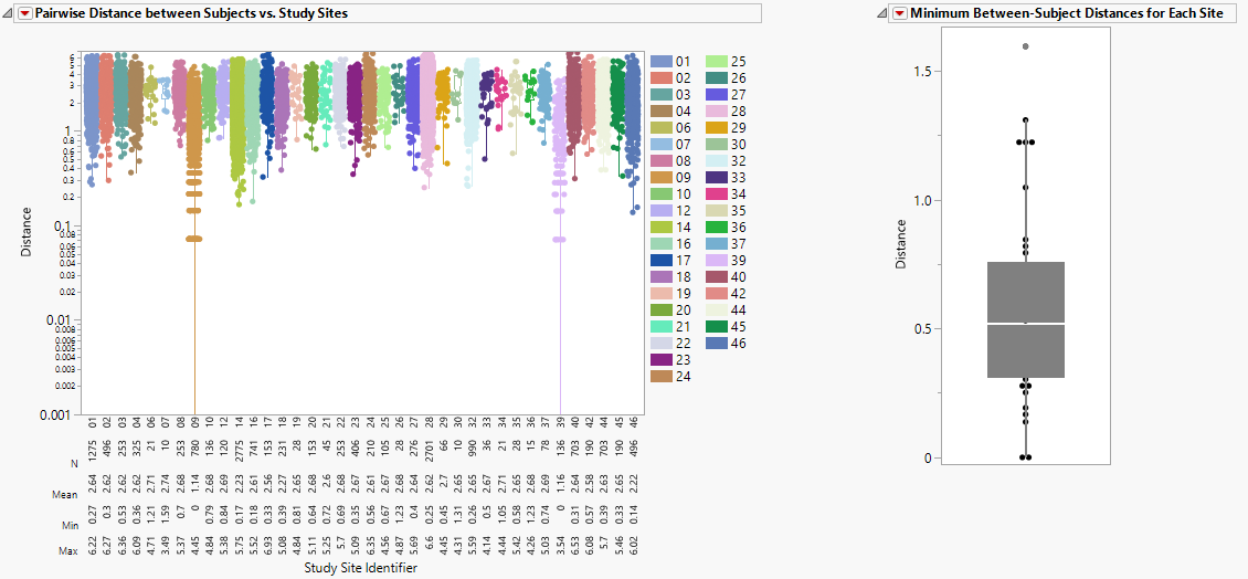

Between-Subject Distance Summary
This section presents box plots of the pairwise Euclidean distances between subjects presented by site and Box Plot of the minimum pairwise distance taken from each site.
It contains the following elements:
| • | One set of Box Plots of Pairwise Distances between Subjects vs. Study Sites. |
This figure shows box plots of all pairwise Euclidean distances within each study site. Individual points are overlaid with the boxplot. The Y-axis is set to log-scale by default for the ease of identifying small distance points when the range of distance is large. A summary table is shown below the boxplot presenting the N, Mean, Min, Max values for each study site. Values closer to zero (0) reflect subjects that are very similar to one another, which could indicate that they are slightly modified copies.
| • | One Box Plot of Minimum Between-Subject Distances for Each Site. |
The box plot of minimum pairwise distances provides some idea of the most similar subjects within each site.

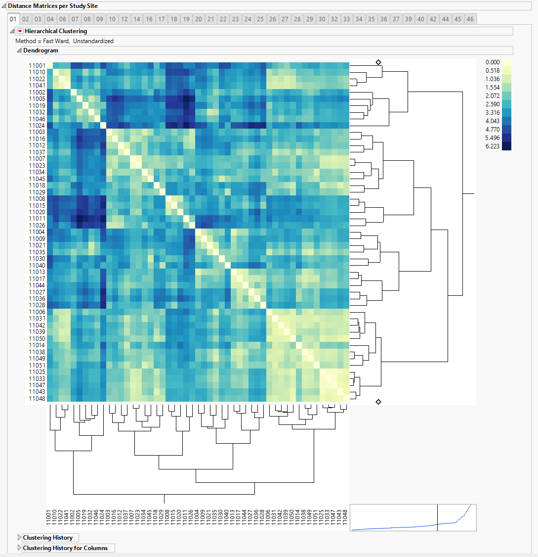

Distance Matrices per Study Site
The Distance Matrices per Study Site section is shown below. There is one panel for each study site in the trial. The panels are named after the study sites' names or IDs.
| • | One Hierarchical Clustering display that clusters subjects based on the Euclidean distance. A heatmap from Hierarchical Clustering is shown with subject IDs being rows and columns annotations. The legend shows the pairwise distance values with a minimum of zero. |
Bluer color indicates subjects that are more similar, whereas yellow shows subjects less similar. The clustering dendrogram is presented to the right of the heat map and can show sets of more than two subjects that are similar to one another. All the pairwise distance matrices, along with the subjects' ID, study sites and treatment arms, are stored in separate jmp tables, and can be accessed by clicking the 'Show Tables' button.

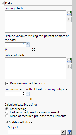

Data
Findings Tests
Use this widget to select Findings Tests for the analysis. The report will autorun and analysis is restricted to the selected tests only.
Exclude tests missing this percentage or more of the data:
By default, findings analyses are conducted assuming that sufficient numbers of subjects have participated to make the results statistically significant. Use this option to specify a threshold at which the level of missing data becomes unacceptable. Tests with levels of missing data exceeding this threshold are removed from the analysis for that visit and time point. The default value for this threshold is 30%, so any tests missing data from more than 30% of the subjects at Visit x are removed from the analysis of that visit.
Subset of Visits
Use the Subset of Visits option to select the visits to be included in the analysis.
Remove unscheduled visits
You might or might not want to include unscheduled visits when you are analyzing findings by visit. Check the Remove unscheduled visits to exclude unscheduled visits.
Summarize sites with at least this many subjects:
The Summarize sites with at least this many subjects: widget enables you to set a minimal threshold for the sites to be analyzed. Only those sites which exceed the specified number of subjects are included. This feature is useful because it enables you to exclude smaller sites, where small differences due to random events are more likely to appear more significant than they truly are. In larger sites, observed differences from expected attendance due to random events are more likely to be significant because any deviations due to random events are less likely to be observed.
Calculate baseline using:
Use the Calculate baseline using: widget to use one of the following: i) baseline flag variable, ii) the last recorded pre-dose measurement, or iii) the mean of all the measurements taken during the baseline time window as the baseline measurement.
Additional Filters - Subject
This filter lets you restrict your analysis to only those subjects that meet specific subject criteria at the domain level (ADSL or DM). The filter uses JMP WHERE clauses to Select Rows that meet the specified criteria. To use this filter, you must enter the JSL (JMP Scripting Language) expressions that constitute the WHERE clause in the appropriate text box for specific filtering of AEs, Disposition, Findings, and/or Subjects. Note: This is an advanced concept that not only requires some basic knowledge of the JSL where clause syntax (similar to, but different from, SQL), but also an understanding of the exact variables in the tables in the study.

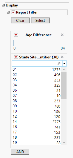

Report Filter
These filters enable you to subset and view subjects based on demographic characteristics (Age Difference), study sites, and other criteria. Refer to Data Filter for more information.
