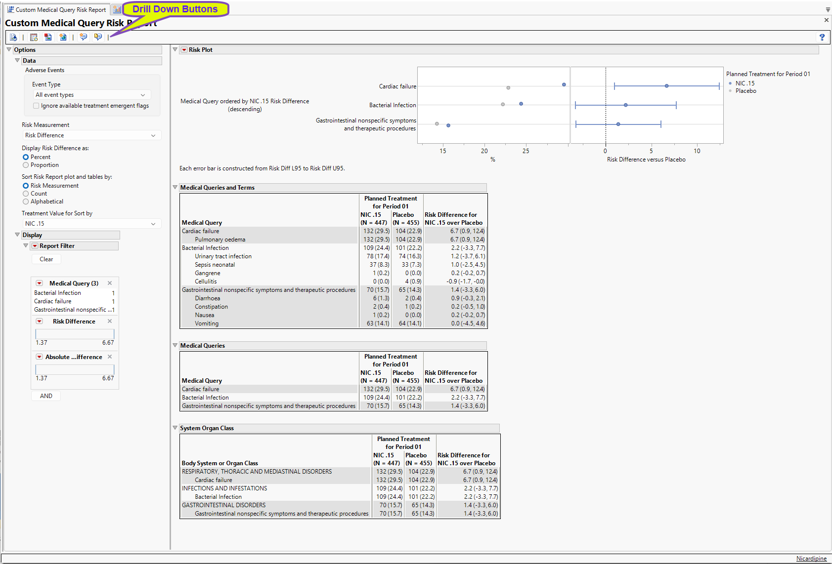

Report Results Description
Running Custom Medical Query Risk Report for the Nicardipine study generates the Report shown below.

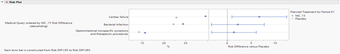

Plots
There are two plots shown here. Medical queries are shown on the y axis. The dot plot on the left shows the percent occurrence of subjects in each arm exhibiting the queries. The Forest plot on the right of each group shows the risk difference for subjects to exhibit events covered by each query.
Forest Plots display relative strength of treatment effects as horizontal lines representing the 95% confidence interval of the effect observed in that trial. The confidence interval is normally for the relative likelihood of a given nominal-level outcome for the intervention group compared to the control group. In this example, the forest plot shown below, represents the risk difference for developing the specified event relative to exposure to Nicardipine.
Note: When you select either Relative Risk or Odds Ratio as the Risk Measurement, the scale on the x-axis of the Forest plot changes from linear to a log scale.
Tables
Three tables were generated for this example.

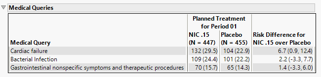

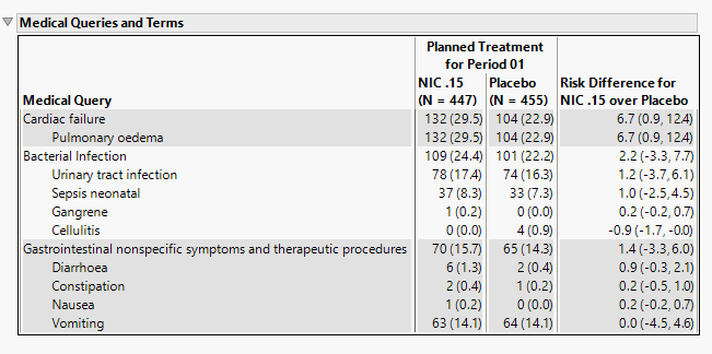

Medical Queries and Terms
This table lists each query with its associated dictionary-derived terms, the number (percent) of subjects exhibiting the event, and the risk difference between the treatment arms.
Medical Queries
This table summarizes each query without the associated dictionary-derived terms for the number (percent) of subjects exhibiting the event, and the risk difference between the treatment arms.

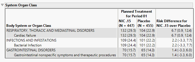

System Organ Class
This table lists the number (percent) of subjects exhibiting each SOC and the risk difference between the treatment arms.

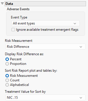

Options
Data
Event Type
Analysis can consider all events or only those that emerge at specific times before, during, or after the trial period. For example, selecting On treatment events as the Event Type includes only those events that occur on or after the first dose of study drug and at or before the last dose of drug (+ the offset for end of dosing).
Ignore available treatment emergent flags
If you choose to ignore available treatment emergent flags, the analysis includes all adverse events that occur on or after day 1 of the study when the event type is Treatment emergent events.
Risk Measurement
Use the Risk Measurement option to specify the measure you want to use for defining risk.
Display Risk Difference as:
Use this widget to specify whether to display the risk difference values as either percentages or proportions.
Sort Risk Report plot and tables by:
Use the Sort Risk Report plot and tables by: widget to specify how the rows in the Risk Report plot and tables are to be sorted.
Treatment Value for Sort by
Use this widget to specify the treatment value to sort the plots and tables by. This is especially useful when there are multiple treatment regimes. Refer to Treatment Value for Sort by for more information.
