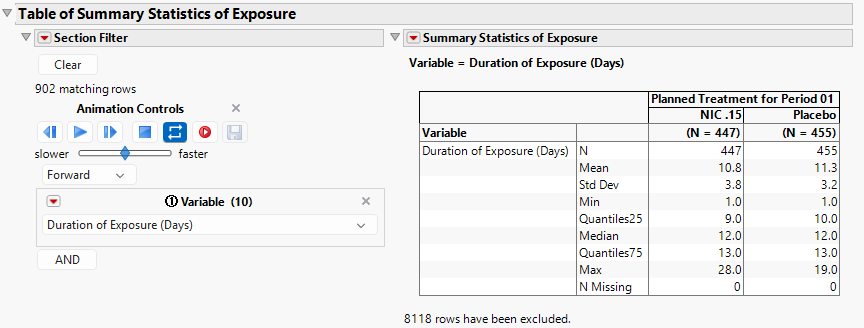

Summary Statistics of Exposure

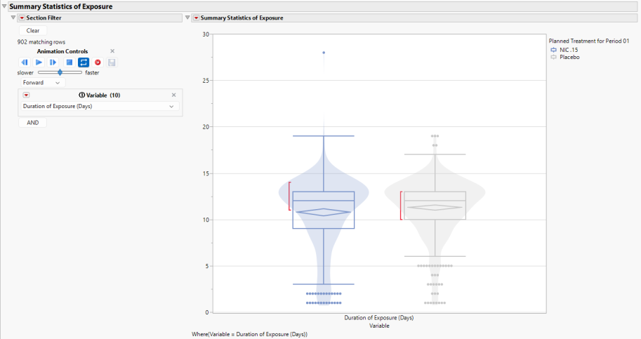

This figure presents bar charts with overlaid violin plots by Treatment Group for each Treatment available in the Exposure (EX) domain to communicate the distributions of the following Variables:
1. Duration of Exposure (Days)
2. Total Dose of Treatment
3. Average Daily Dose Over the Duration of Exposure
4. Frequency of Days Receiving Treatment
5. Percent of Duration Days Receiving Treatment
6. Average Daily Dose Over the Days Receiving Treatment
7. Frequency of Dosing Gaps
If Dosing Gaps are observed, the following additional variables are summarized:
8. Min(Duration of Dosing Gap (Days))
9. Median(Duration of Dosing Gap (Days))
10. Max(Duration of Dosing Gap (Days))
Use the section filter, at left, to specify the variable displayed in the plot. Alternatively use the animation control to cycle between all of the variables.
Any markers present in the graph highlight outliers for a particular Variable. The confidence diamond displays the width of the 95% confidence interval around the Variable mean, with the widest point of the diamond illustrating the mean value. The red bar communicates the “shortest half”, which is the densest 50% of the observations.
Summary statistics are provided in the Table of Summary Statistics of Exposure (below).

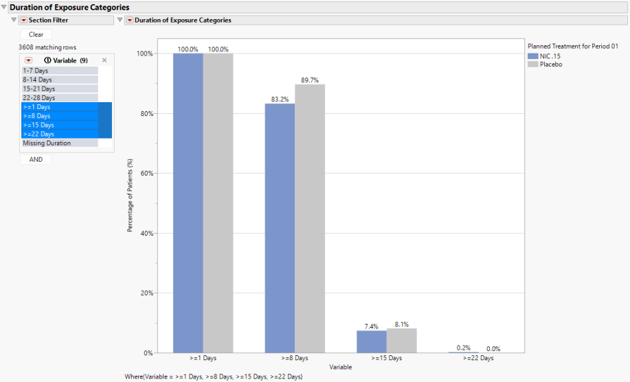

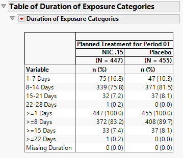

Duration of Exposure Categories
Categorical Variables of Duration of Exposure (Days) are presented in the next two sections of output and are determined by the Dosing Interval (Days) option. Graphical results are shown above.
For Nicardipine, in addition to the category of Missing Duration, 4 individual and 4 cumulative categories are created based on 7-day increments.
| • | Individual |
a. 1-7 Days
b. 8-14 Days
c. 15-21 Days
d. 22-28 Days
| • | Cumulative |
a. >=1 Days
b. >=8 Days
c. >=15 Days
d. >=22 Days
| • | Missing Duration |
While it is possible to present all binary Variables at once due to the similarity of scale, the cumulative indicators are presented by default to minimize crowding. The y-axis Percentages of Subjects (%) can be changed to Frequency of Subjects using the Display Option.
Summary statistics are provided in the Table of Duration of Exposure Categories.
Note that the results in this section would be presented by Treatment and Period if subjects happen to receive more than one Treatment and/or the clinical trial had multiple Periods.

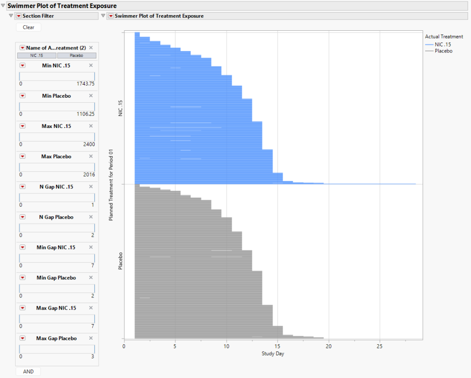

Swimmer Plot of Treatment Exposure
The Swimmer Plot displays the subject journey from when they first begin any Treatment until they end their last Treatment. Subjects are sorted by the maximum end date for any Treatment and presented within Treatment Group.
Here, we can observe a few details:
| • | Both the Nicardipine and Placebo groups had subjects discontinue Treatments early, and there was a fairly consistent pattern of Treatment discontinuation over time between the two Treatment Groups. |
| • | Despite being a two week study, there are a few subjects whose treatment exceeded Study Day 14, with one individual on NIC .15 being treated until Study Day 28. |
| • | There are some Dosing Gaps present, though with approximately 450 subjects (rows) presented for each level of the Treatment Group, this is difficult to discern. This is where the Section Filter becomes extremely useful. |
The section filter includes the following variables:
| • | Treatment: This will include values for the Name of the Actual Treatment (EX.EXTRT) that are observed in the Exposure (EX) domain. |
| • | Treatment Minimums and Maximums: The minimum and maximum daily doses for each Treatment are available to filter subjects. For example, there are Min NIC. 15 and Max NIC. 15. |
| • | Frequency of Treatment Gaps: The frequency of Dosing Gaps of at least one day for each Treatment are available to filter subjects. For example, there are N Gap NIC. 15 and N Gap Placebo. For NIC. 15, there are subjects with 0 or 1 Dosing Gaps. For Placebo, there are subjects with 0, 1, or 2 Dosing Gaps. |
| • | Dosing Gap Minimums and Maximums: The minimum and maximum Dosing Gap duration (in days) for each Treatment are available to filter subjects. For example, there are Min Gap Placebo and Max Gap Placebo. |
The Section Filter variables makes it straightforward to find individuals with unusual daily doses, or frequent and lengthy (or brief) Dosing Gaps.
Lines in the swimmer plot extend 0.5 before the first dose and 0.5 days after the final dose of a drug. This feature was included so that subjects transitioned from one drug to a new drug during the course of treatment would not show a gap in treatment. For example, if a subject is dosed from Day 1 to 8, and starts a new drug from Day 9 to 15, this would create a break in the line from Day 8-9 which makes it looks like there was an interruption. To avoid this, the line is drawn from Day 1 to 8.5 and 8.5 to 15 so that the line looks continuous. While the 0.5 day is artificial, everything within this report works at the day level, and users hovering over the point will see the correct stop and start dates/days.
Annotated Swimmer Plot
When filtering, either through the Section Filter or Review Subject Filter, once 50 or fewer subjects are reached, an annotated view of the Swimmer Plot is provided which focuses on subjects and presents markers of changing dose. Hovering over the markers will provide the dose as well as the Start and End Dates and Study Days of the Treatment at this particular dose. Each marker represents a change in dose, so subjects with numerous markers reflect numerous dose changes.
Note that if two or more treatments are taken on the same day of a subject, the combination of those Treatments is considered a separate Treatment. Admittedly, the Nicardipine study is a challenging example to summarize exposure in a Swimmer Plot. Because the drug is given intravenously and the amount of drug received is proportional to the amount of time the subject is treated, frequent dosing changes occur over the study. There are just too many changes to represent particular doses with unique colors in the Swimmer Plot to effectively communicate what subjects are taking without relying on markers. However, for studies where the number of treatments is low with a small number of unique daily doses, Exposure Summary will utilize more effective colors to present the Swimmer Plot. Here are the general guidelines:
| • | With 4 or more Treatments or combination of Treatments observed on the same day, the Swimmer Plot will summarize Treatments using colors from the JMP standard color table. |
| • | With 3 or fewer Treatments or combination of Treatments observed on the same day, three-level blue, red, and gray scales will be used to summarize Treatments with 3 or fewer doses. Should a Treatment have more than 3 doses, the Treatment is described using a single color from one of the 3 color scales. At most, 9 colors (3 shades of 3 colors) will be presented in a Swimmer Plot. Colors are selected to maximize the contrast between doses. |

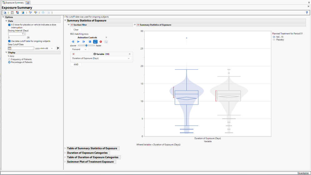

Options
Data
A 0 dose for placebo or vehicle indicates a dose interruption
Check this box when Placebo or Vehicle Treatments contain a 0 dose (EX.EXDOSE). Checking this box is equivalent to no Placebo or Vehicle being taken during this time (a Treatment Interruption). When this box is unchecked, doses of zero are interpreted as a period when placebo or treatment were given (i.e. no dose interruption).
This option derives binary indicator variables to summarize the Duration of Exposure categorically. Defaults (shown below) are assumed based on the maximum Duration of Exposure across all Treatments. Otherwise, approximately 4 equal-sized intervals are produced.
| Maximum Duration of Exposure | Default Interval |
| > 540 days (~18 months) | 90 days |
| >90 days (~3 months) | 30 days |
| > 14 days | 7 days |
Use data cutoff date for ongoing subjects
For subjects who are ongoing in the study, it is useful for indicating the date on which the data for this update report was pulled, particularly when considering exposure data. The Use data cutoff date for ongoing subjects and Data Cutoff Date widgets enable you to specify and use a data cutoff date for reporting on ongoing subjects.
Check this box to use the date on which the study data was pulled for this report in place of exposure end date for ongoing subjects.
Data Cutoff Date
Use this widget to specify the date on which the study data was pulled for this report.
Number at Risk Interval (days)
Enter the number of days comprising the block of time between study days where the number of subjects remaining in the study are reported.
Color Risk Table by Treatment
Use this option to color the numbers in the Risk Table by treatment.
Display
Number at Risk
Use this option to specify whether to calculate risk for all subjects or just those experiencing cumulative events. All Patients, which is set by default, displays the number of patients currently at risk in the analysis (i.e., those who have yet to have an event or be censored). Cumulative Events displays the number of patients who have experienced an event by the given time point.
Y-Axis
Use this option to specify whether to plot the results in terms of frequency or percentage of subjects.
