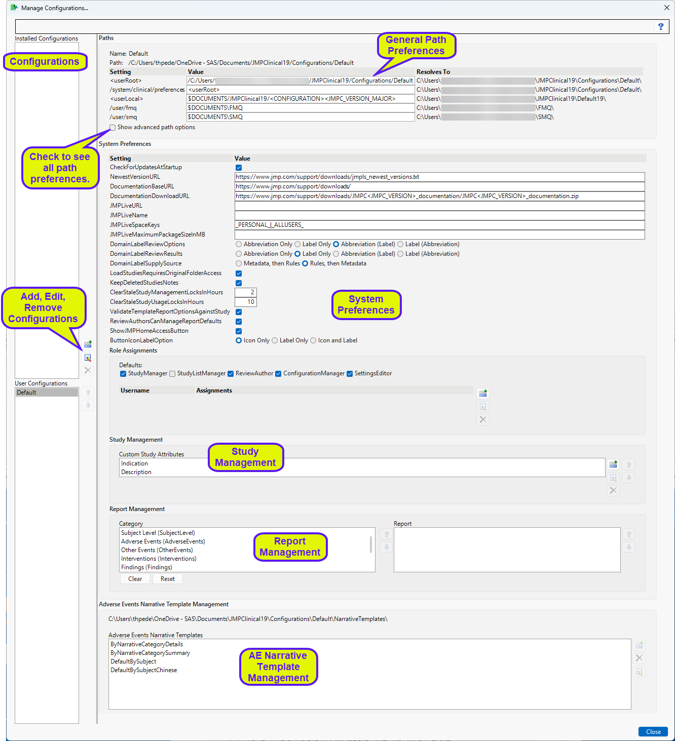

Manage Configurations
The Manage Configurations... window is accessed from the Settings tab of the JMP Clinical Main Window.
8 Click to open the Manage Configurations... window, shown below:

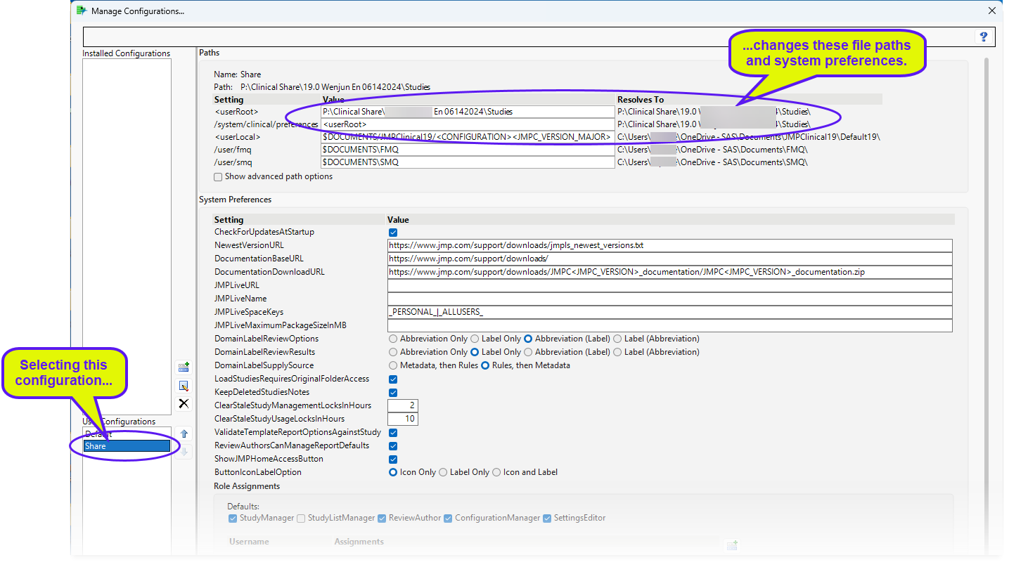

The Add window appears as shown below:
8 Click .
The new configuration is added to the Manage Configurations window. If you select it, all of the default paths and system preferences are displayed, as shown below:
Note: While all paths and preferences are editable, you should consult your system administrator before making any changes.
8 Click to close the Manage Configurations window.
