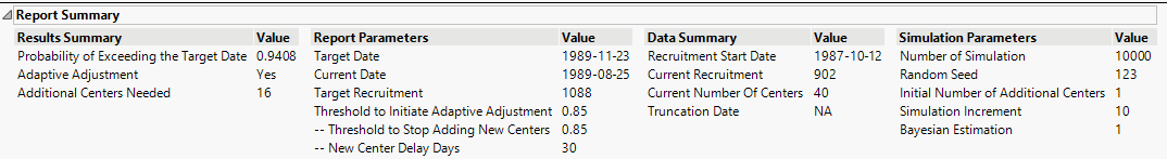

Report Summary
Displays a summary of the study, parameters used in simulations, and predicted results with regards to patient recruitment.

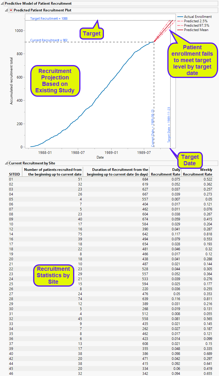

Predictive Model of Patient Recruitment
Displays recruitment history and predictions.
This section contains the following
| • | One plot showing patient recruitment over time along with the projected recruitment, based on recruitment history and assuming the number of study sites remains the same. Target recruitment numbers and deadline are indicated. To meet study requirements, projected enrollments must reach target levels before the deadline. |
In this example, projections suggest that, given the established number of study sites and rate of recruitment, the study will fail to recruit the desired number of subjects by the target date.
| • | One table summarizing recruitment statistics. |
Note: When predicted subject enrollment is insufficient, as shown in this example, the Adaptive Adjustment protocol is invoked.

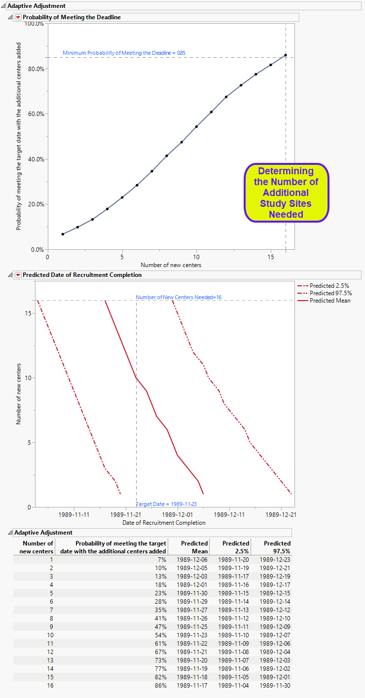

Adaptive Adjustment
Displays the predicted probability of meeting the target date with the additional centers added, and the Date of Recruitment Completion as the number of new centers increases.
Note: This section is displayed only when recruitment is predicted to be insufficient.
The Adaptive Adjustment section contains the following elements:
| • | One plot showing the predicted probability of meeting the target date with the additional centers added, with a reference line for the Minimum Probability of Meeting the Deadline at 85% (by default). |
In this example, a minimum of 16 additional centers are needed to meet recruitment goal by the target date.
| • | One plot showing the expected date of completion, given different numbers of additional centers. |
In this example, the predicted date of completion is met only by the addition of 16 new centers.
| • | One table summarizing the adjustment statistics. |

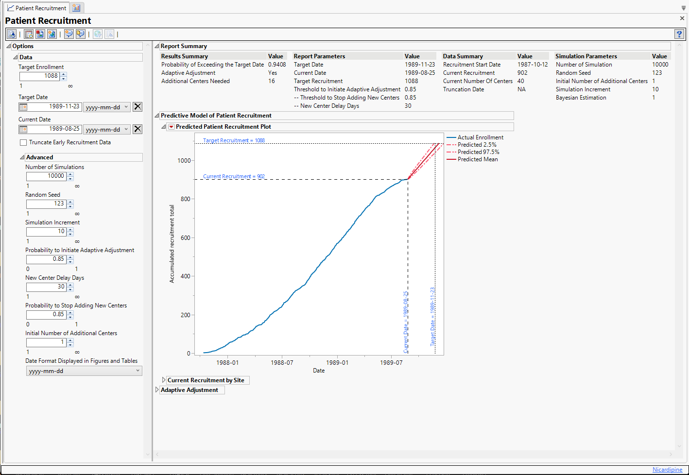

Options
Data
Use the options on this panel to customize your analysis.
Target Enrollment
The Target Enrollment option enables you to specify the number of subjects needed across all study sites for the study. This number needs to be greater than the current total enrolled subjects.
Target Date
The Target Date option enables you to specify the anticipated start date for the study. The date needs to be later than the Current Date.
Current Date
The Current Date option enables you to specify the current date. By default, this is the randomization date of the last enrolled subject.
Truncate Early Recruitment Data
The Truncate Early Recruitment Data option enables you to choose a start date to truncate early recruitment data.
Truncation Date
The Truncation Date option enables you to specify the start date for truncating early recruitment data. This option is available only when the Truncate Early Recruitment Data option is checked. The date needs to be later than the recruitment start date, and earlier than the Current Date.
Number of Simulations
The Number of Simulations option enables you to specify the number of simulations to be performed on the Poisson-Gamma modeling that are used to predict future enrollment. The default value is 10000. Smaller values may decrease the accuracy of the estimated recruitment date; while larger values may increase the computational time.
Random Seed
The Random Seed option enables you to specify a value used to generate reproducible random samples from specified distributions.
Simulation Increment
The Simulation Increment option is used to specify the amount of increment in enrollment when simulating the remaining time from current enrollment up to total enrollment. The default value is 10. If the total remaining number of patients to recruit is less than 50, the Simulation Increment parameter will be automatically adjusted to a smaller number.
Probability to Initiate Adaptive Adjustment
The Probability to Initiate Adaptive Adjustment option is used to specify the probability threshold for meeting the deadline before initiating adaptive adjustment. The default value is 0.85.
New Center Delay Days
The New Center Delay Days option is used to specify the number of days recruitment is delayed at the new centers. This value is taken into account when predicting the time remaining. The default number is 30.
Probability to Stop Adding New Centers
The Probability to Stop Adding New Centers option is used to specify the minimum probability threshold for meeting the target recruitment by the deadline. The default value is 0.85.
Initial Number of Additional Centers
The Initial Number of Additional Centers option is used to specify the initial number of new centers to be added to increase enrollment rate. The default value is 1.
Date Format Displayed in Figures and Tables
The Date Format Displayed in Figures and Tables option is used to specify the format of the date and time in figures and tables.
