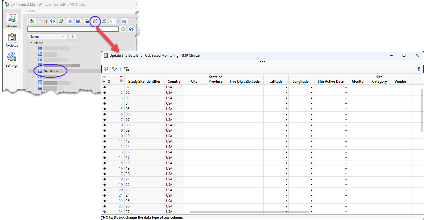

To Update the Site Details Data
| 8 | Open the Studies window and highlight the study you want to update. |
| 8 | Click to open a Site Details table. |
| 8 | Enter the details in the relevant columns. Note: You should not change the data type of the columns from their specified type. |
| 8 | Once you are finished, click to save the table. |

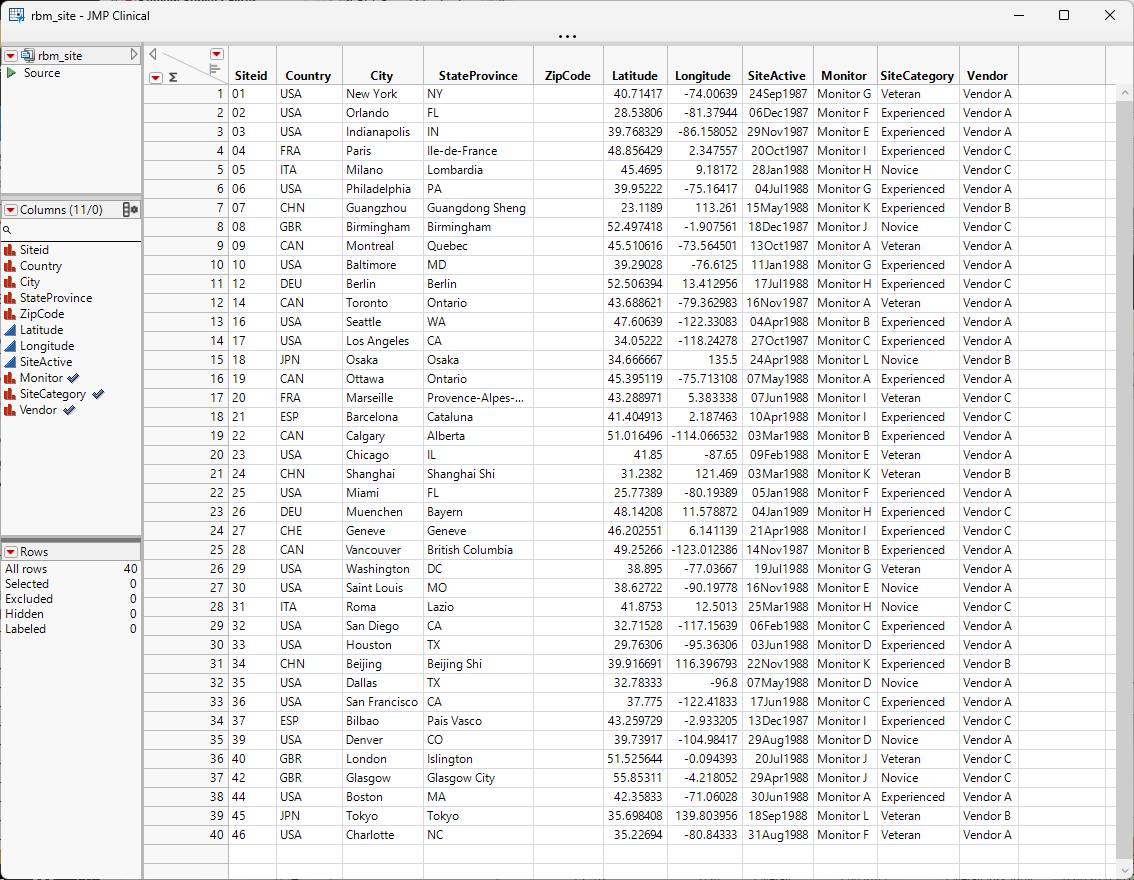

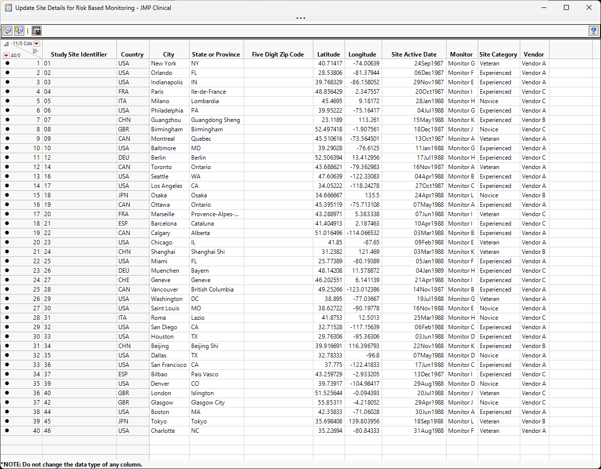

Example: Site Details for the Nicardipine Study
The Site Details data set for the included Nicardipine sample data is already populated and is shown below.
The Site Details data table for the Nicardipine example data (shown above) is included with JMP Clinical. This file can be found in the Notes directory of the Nicardipine study, if Nicardipine is registered in JMP Clinical (C:\Users\username\Documents\JMPClinicalversion\Configurations\Default\Notes\Nicardipine on Windows and in /Users/username/Documents/JMPClinicalversion/Configurations/Default on Macs) or in the installation folder (C:\ProgramData\JMP\JMPClinical\version\Clinical\Sample Data\Nicardipine on Windows and /Library/Application Support/JMP/JMPClinical/version/Clinical/Sample Data/Nicardipine on Macs).
