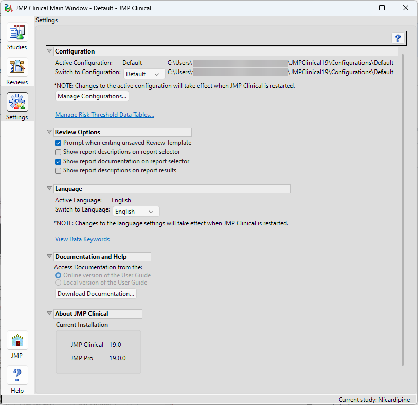

Settings
The Settings tab is used to specify general settings that apply across all JMP Clinical functions and reports.
Configuration
Use this feature to choose where to access the study information. Local specifies the default folder on your machine’s hard drive (typically C:\Users\username\JMPClinical**\Configurations\Default (The ** indicates the version of the JMP software included in JMP Clinical.) on a Windows machine and /Library/Application Support/JMP19/Clinical on a MAC). Other options (such as “Shared") indicates a location on a network drive that has been set up for use by multiple users.
Use the Switch to Configuration drop-down menu to select an alternate configuration. You must the click and then reopen JMP Clinical to effect the change.
Adding a New Configuration and/or Modifying an Existing Configuration
The configuration of your JMP Clinical installation can be modified to meet the specific needs of your organization. Use the to add or modify a configuration. Please note that because the files governing the default configuration are typically located in the install folder, users who do not have write privileges for this folder will be unable to modify the default configuration. An alternative option for these users is to add a new configuration in a writeable location. Refer to Manage Configurations for more information.
Options you can set in a new configuration include:
File Paths
This section displays the current configuration, the paths to the user root directory, system preferences, and user documentation and other files used and created by JMP Clinical. An option for viewing the paths to all relevant directories can be selected.
Refer to File Path Options for a Configuration for more information
System Preferences
Refer to System Preferences for a Configuration for descriptions of system preferences and instructions for their customization.
Role Assignments
The following user roles can be set for individual users.

Manage Risk Threshold Data Tables
A link is provided to the Risk Threshold data sets. Refer to Manage Risk Threshold Data Tables... for more information.
Review Options
| 8 | By default, JMP Clinical prompts you to save Unsaved Review Templates when exiting them. To block this prompt, deselect the Prompt when exiting unsaved Review Template check box. |
| 8 | Check the Show report descriptions on report selector check box to show a description of the reports on the Report Selector. |
| 8 | Check the Show report documentation on report selector check box to show the report's documentation page on the Report Selector. |
| 8 | Check the Show report descriptions on report results check box to show a description of the report at the top of the report results window. |
Language
JMP Clinical supports use of either both English and Chinese languages, as well as partially supporting Japanese.
| 8 | Use the drop-down menu to change language usage by JMP Clinical. |
Language options include English, Japanese, and Chinese.
| 8 | You must exit and relaunch JMP Clinical in order for the language change to take effect. |

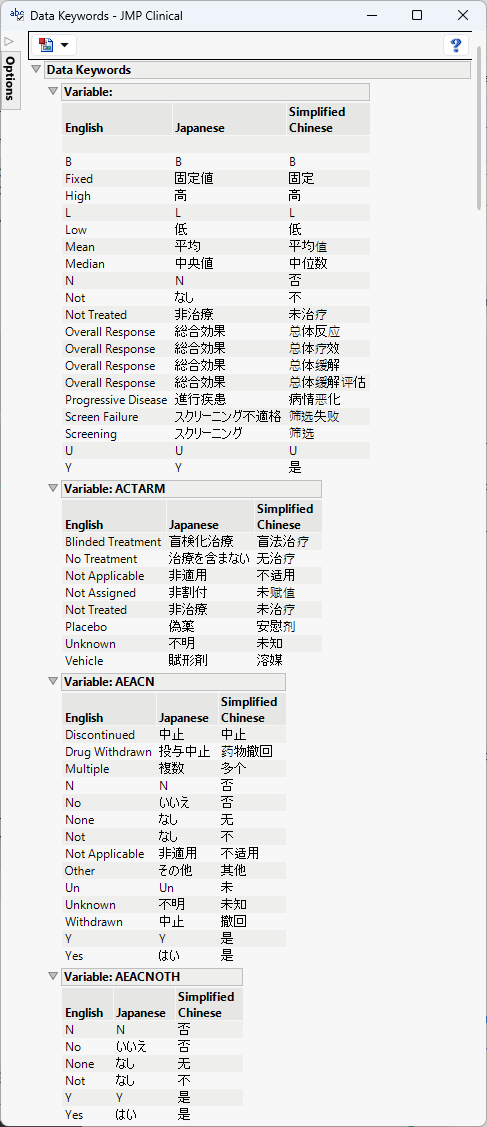

Data Key Words
| 8 | Click View Data Keywords to open the Data Keywords window showing the English, Japanese, and Chinese translations for specific keywords used by JMP Clinical. |
Documentation and Help
By default, JMP Clinical accesses the JMP Clinical User Guide, an online documentation, and Help system. You can also download the documentation to your local drive and specify which version (local or online) of the JMP Clinical User Guide to access.
| 8 | Click to download and install the JMP Clinical User Guide to your local machine. The default location for the downloaded documentation is $DOCUMENTS/JMPClinical19/Documentation. |
The download process can take several minutes. A window opens, showing the progress of the download.
The option for selecting either the online or local versions of the documentation become active once the download has completed.
About JMP Clinical
This section provides version numbers for the different components of your JMP Clinical installation
