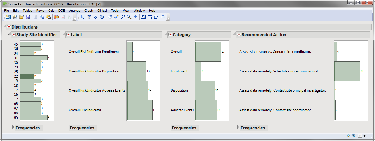

Opens a set of distributions for a subset of the study sites showing actions to take for each of the selected study sites.

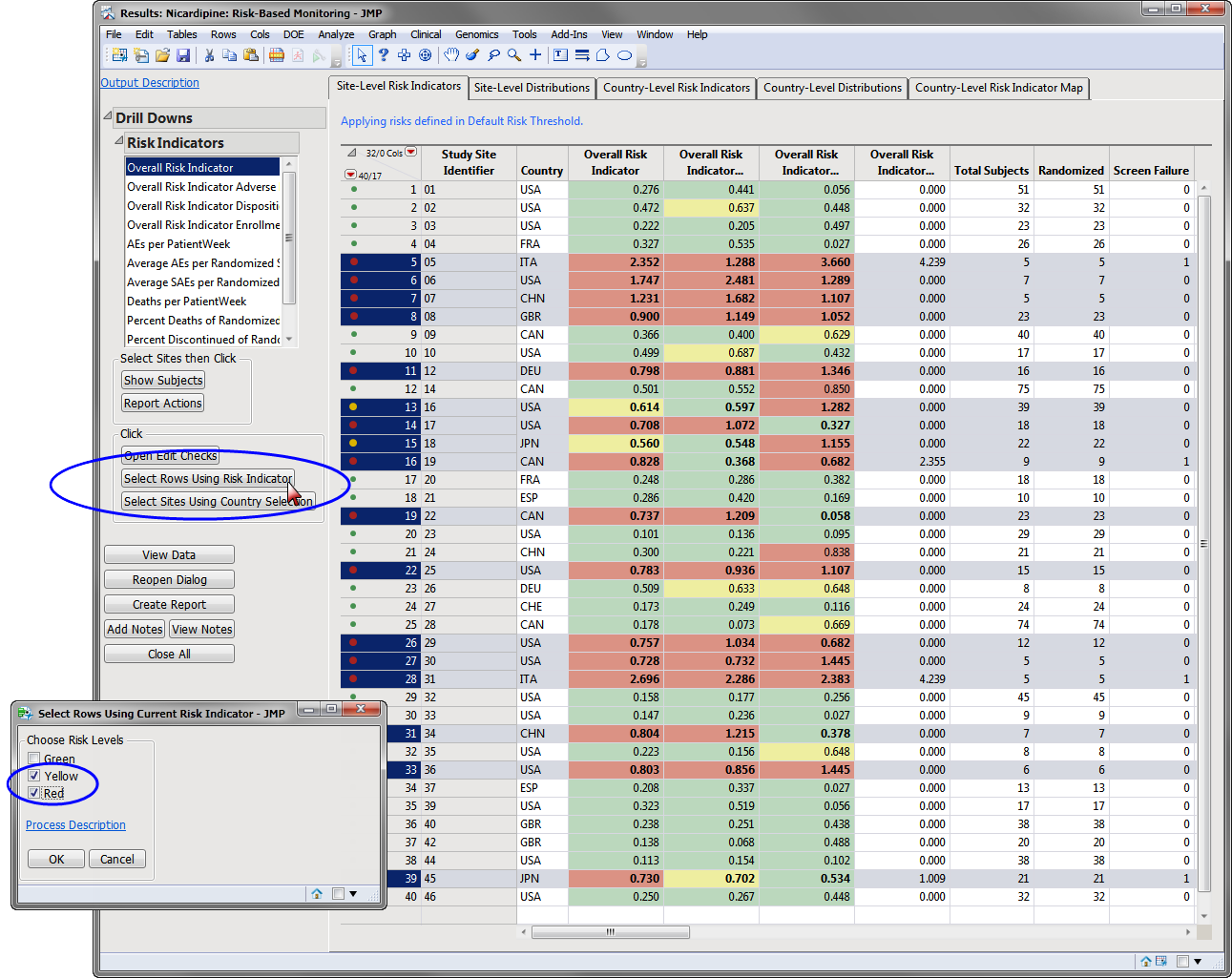

In the following example, sites highlighted in red (high risk) and yellow (intermediate risk) were selected using the -down button, as shown below:
Clicking opens the following set of distributions:
Site 22 is highlighted. This site shows an intermediate overall risk with a recommendation to contact the site. However, because, the risk indicator for disposition is high, an on-site visit is recommended.
