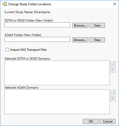

Change Study Folder Locations
Use this option to move a study from location to another. Note: You must manually move the study and data files to the new folders before using this option.
8 Click to open the following window:
8 Enter the path to the folders where you have manually moved your SDTM (or SEND) folder and the ADaM folder. Usually, these location folders are the same. You can either manually enter the path into the text box or click and browse to the folder.
8 Click to view the contents of the folder.
8 Indicate whether you are importing SAS transport files.
You can specify subsets of the SDTM and/or ADaM domains to include in your moved study.
To specify selected SDTM or SEND domains:
8 Click to open the Add window shown below:
8 Highlight the desired domains and click .
8 Repeat, as needed, for selected ADaM domains.
8 Once you have made your selections, click to move the study.
