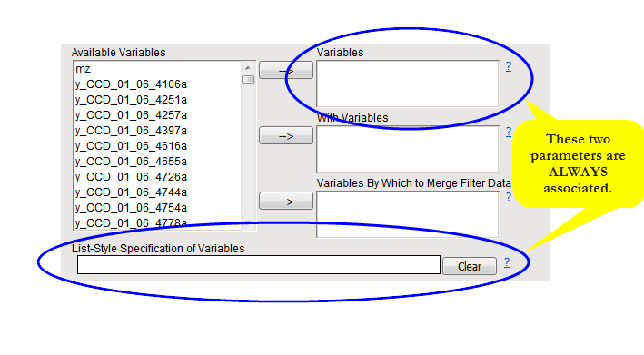

button. A typical List-Style Specification field is shown below:
List-style specification fields are always associated with a variable field, as illustrated below:
You can use one or the other or both fields to specify the requisite variables. The methods for this specification are described in the table below:
