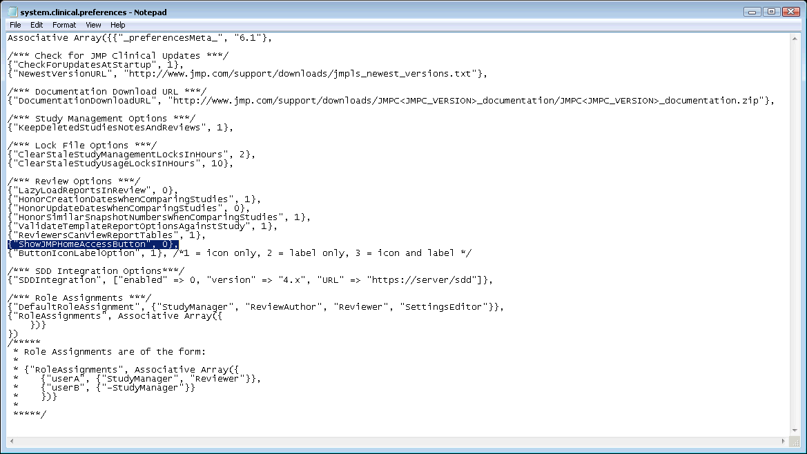

You must first modify the system.clinical.preferences file (the default local location for this file is the C:\Program Files\SASHome\JMPClinical\12\LifeSciences directory).
8 Open the system.clinical.preferences file with a text editor.
The file shown below opens. The text to be modified is highlighted.
8 To view the JMP Home button change {“ShowJMPHomeAccessButton”, 0} to {“ShowJMPHomeAccessButton”, 1}.
Note: You must include the quotation marks as shown in the text above. Entries are case-sensitive.
8 Save and close the system.clinical.prefereneces file.
8 In order for these changes to be registered, you must exit and reopen JMP Clinical.

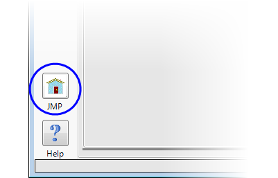

A JMP Home button () is added to the JMP Clinical Main , as shown below:

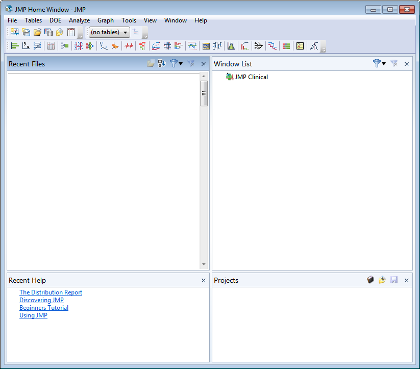

Accessing JMP:
8 Click the icon to open the JMP Home (shown below).
Use the Help menu to access the JMP Help system for documentation, tutorials, and other information about using JMP.
