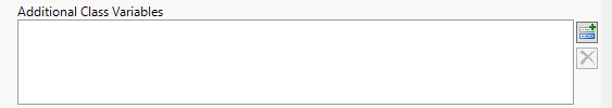

To Specify Additional Class Variables:

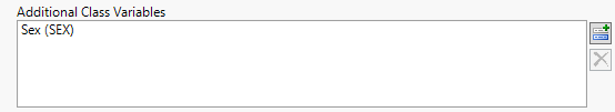

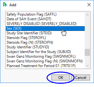

8 Click to open the Add window (shown below) that lists each variable contained in ADSL or the domain and SUPPxx (if merged) specific to this report.
8 Select the variables you want to include in the analysis and click to add those variables to the text box.
In this example, SEX was selected and added.
