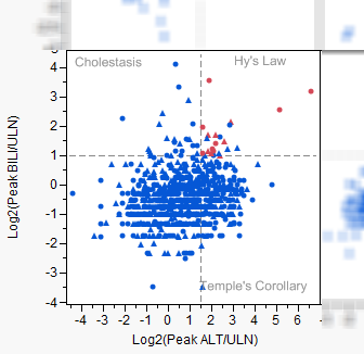

Example Output Using This Option
A portion of a Scatterplot Matrix annotated using this option is shown below.
