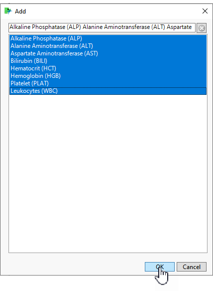

8 Click to open the Add window (shown below) that lists each variable contained in ADSL or the available Findings domains and respective SUPPxx data sets (if merged).
8 Select the tests you want to include in the analysis and click to add those variables to the text box.
In this example, ALP and BILI were selected and added.

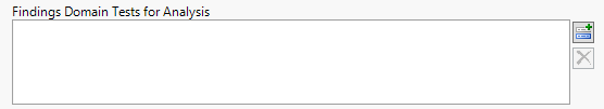

8 Open the first Findings report. In this example, we are using Findings Time Trends. Select the desired Findings tests as described above.
The filled text field is shown below:

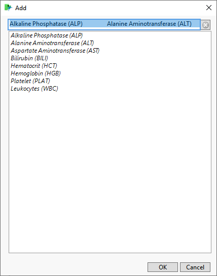

8 Open the next report (in this example, we'll use Findings Waterfall Plots) and click to open the Add window.
8 Paste the copied tests into the text box at the top of the window.
The Findings tests are subsetted and only the selected tests are shown in the window.
8 Highlight the tests and click .
The findings domain tests originally selected in Findings Time Trendsare now selected in Findings Waterfall Plots.
