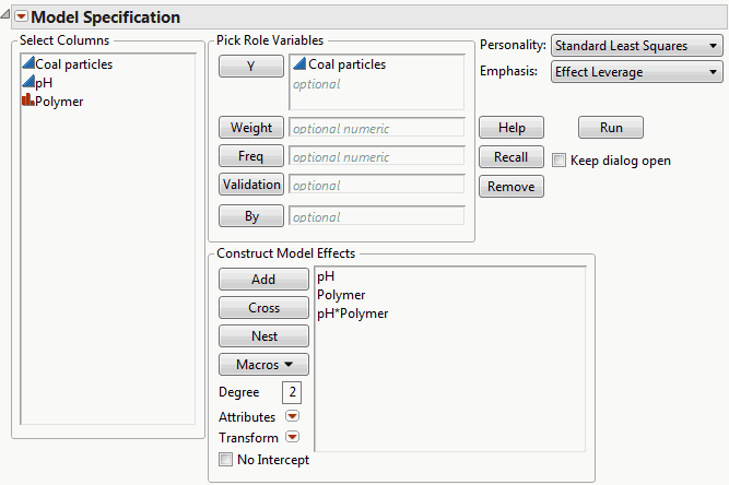

Open Cleansing.jmp. You are interested in whether any of the three polymers (Polymer) has an effect on coal particle removal (Coal particles). The tank pH is included as a covariate as it might affect a polymer’s ability to clean the tank. You allow for possibly different slopes when modeling the relationship between pH and Coal particles for the three Polymer types.
Select Analyze > Fit Model.
Select Macros > Full Factorial.
The Fit Model window appears as shown in Fit Model Window for Analysis of Covariance, Unequal Slopes.

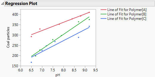

When you click Run, the Fit Least Squares report appears. The Effect Tests report indicates that the interaction between pH and Polymer is significant and should be included in the model.
The Regression Plot given in the report is shown in Model Fit for Analysis of Covariance, Unequal Slopes. This plot shows the points and the model fit. The interaction allows the slopes of the lines that relate pH to Coal particles to depend on the Polymer. Note that, despite this interaction, over the range of interest, Polymer A consistently has the highest removal. If you want to color the points as shown in Model Fit for Analysis of Covariance, Unequal Slopes, select Rows > Color or Mark by Column, select Polymer from the Mark by Column list, and click OK.
