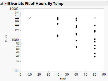

In the Devalt.jmp data, units are stressed by heating, in order to make them fail soon enough to obtain enough failures to fit the distribution.
Select Analyze > Fit Y by X.

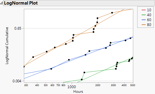

Select Analyze > Reliability and Survival > Survival.
7.
8.
9.
10.
11.
Click OK.

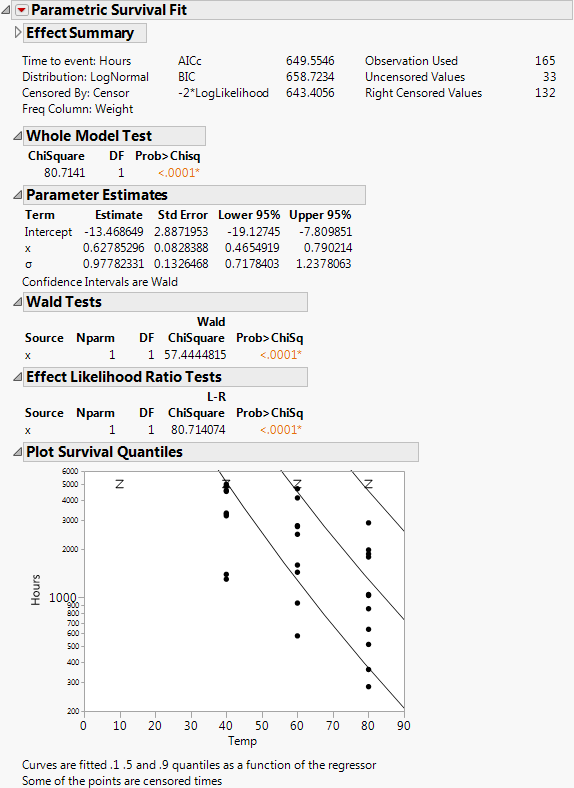

Select Analyze > Reliability and Survival > Fit Parametric Survival.
14.
15.
16.
17.
18.
19.
Click Run.
If the effect column has a formula in terms of one other column, as in this case, the plot is done with respect to the inner column. In this case, the effect was the column x, but the plot is done with respect to Temp, of which x is a function.

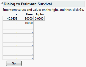

From the red triangle menu, select Estimate Survival Probability.
21.
Enter the values shown in Estimating Survival Probabilities into the Dialog to Estimate Survival.
22.
Click Go.
