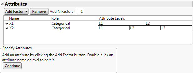

Tip: When you have completed the Attributes outline, consider selecting Save Factors from the red triangle menu. This saves the attribute names, roles, and levels in a data table that you can later reload and reuse.
Adds multiple attributes. Enter the number of attributes to add, click Add Factor, and then select the number of levels. Repeat Add N Factors to add multiple attributes with different numbers of levels.
Name of the attribute. Attributes are given default names of X1, X2, and so on. To change a name, double-click it and type the desired name.
For each attribute, JMP saves the Value Ordering column property to the data tables constructed by the Choice platform. The Value Ordering column property specifies that levels appear in reports using the ordering specified in the Attributes outline. For details, see Value Ordering in Column Properties.
