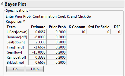

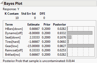

The specifications window, showing default settings for a Bayes Plot for the Bicycle.jmp sample data table, is shown in Bayes Plot Specifications. Clicking Go in this window updates the report to show Posterior probabilities for each of the terms and a bar chart (Bayes Plot Report).

Click Go to calculate the posterior probabilities.
