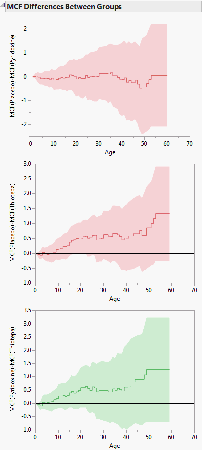

To examine if there are differences among the treatments, select the Plot MCF Differences command from the platform red triangle menu to get the following plots.
To determine whether there is a statistically significant difference between treatments, examine the confidence limits on the differences plot. If the limits do not include zero, the treatments are convincingly different. The graphs in MCF Differences show there is no significant difference among the treatments.
