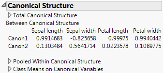

Shows or hides Canonical Structures report. See Show Canonical Structure. Not available for the Wide Linear discriminant method.

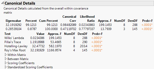

The Canonical Details report shows tests that address the relationship between the covariates and the grouping variable X. Relevant matrices are presented at the bottom of the report.
Canonical correlations between the covariates and the groups defined by the categorical X. Suppose that you define numeric indicator variables to represent the groups defined by X. Then perform a canonical correlation analysis using the covariates as one set of variables and the indicator variables representing the groups in X as the other. The Canonical Corr values are the canonical correlation values that result from this analysis.
Likelihood ratio statistic for a test of whether the population values of the corresponding canonical correlation and all smaller correlations are zero. The ratio equals the product of the values (1 - Canonical Corr2) for the given and all smaller canonical correlations.
Lists four standard tests for the null hypothesis that the means of the covariates are equal across groups: Wilk’s Lambda, Pillai’s Trace, Hotelling-Lawley, and Roy’s Max Root. See Multivariate Tests and Approximate F-Tests in Discriminant Analysis.
F value associated with the corresponding test. For certain tests, the F value is approximate or an upper bound. See Approximate F-Tests in Discriminant Analysis.
p-value for the corresponding test.
Coefficients used to compute canonical scores in terms of the raw data. These are the coefficients used for the option Canonical Options > Save Canonical Scores. For details about how these are computed, see “The CANDISC Procedure” in SAS Institute Inc. (2011).
Coefficients used to compute canonical scores in terms of the standardized data. Often called canonical weights. For details about how these are computed, see “The CANDISC Procedure” in SAS Institute Inc. (2011).
