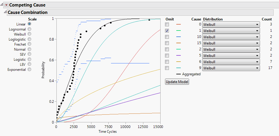

5.
Select Likelihood as the Confidence Interval Method.
6.
Select Allow failure mode to use fixed parameter models.
7.
Click OK.

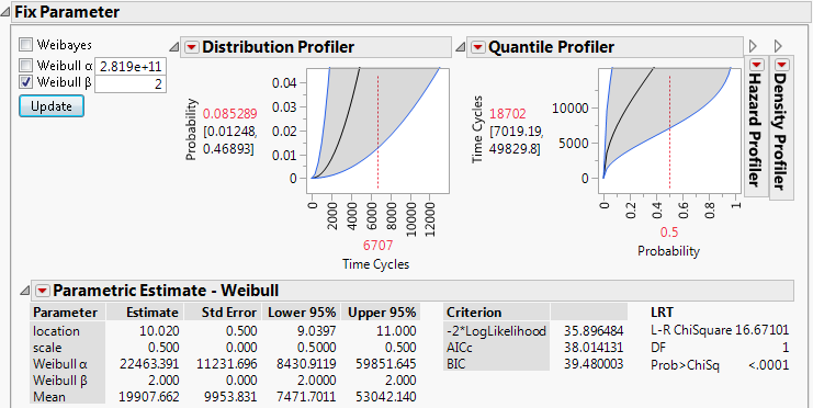

9.
Select Fix Parameter from the red triangle next to Parametric Estimate - Weibull.
10.
Select Weibull beta and type 2.
11.
Click Update.
In the Parametric Estimate - Weibull report, assuming β equals 2, the alpha parameter is estimated to be 22463.391. Now you can use this for the failure distribution for Cause=1.

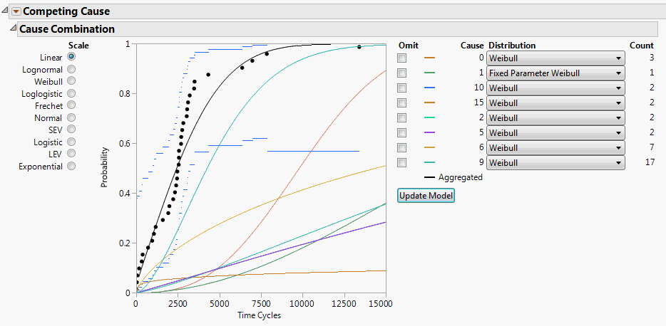

13.
Deselect Omit for Cause 1.
14.
For the distribution for Cause 1, select Fixed Parameter Weibull.
15.
Click Update Model.
