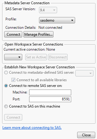

To begin, select File > SAS > Server Connections. The SAS Server Connections window shown in SAS Server Connections appears. All connections are made in this window.
Select File > SAS > Server Connections. The SAS Server Connections window shown in SAS Server Connections appears.
Click Connect.

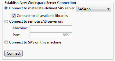

Note: Connect to all available libraries is selected by default based on the SAS Integration preferences. This option connects metadata-defined SAS libraries automatically across all JMP sessions. When the Workspace Server contains a large number of metadata-defined SAS libraries, consider deselecting this option to speed up your connection to the server.
Click Connect.

In the SAS Server Connections window, select the SAS Server Version.

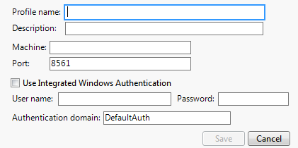

Click Manage Profiles.
The name of the machine that hosts the Metadata Server. (Example: myserver.mycompany.com)
Click Save.

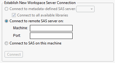

You can also connect directly to a SAS Workspace Server, instead of going through a Metadata Server.
Under Establish New Workspace Server Connection, select Connect to remote SAS server on. See Open a Connection to a Remote SAS Server.
Click Connect.
Click OK.
