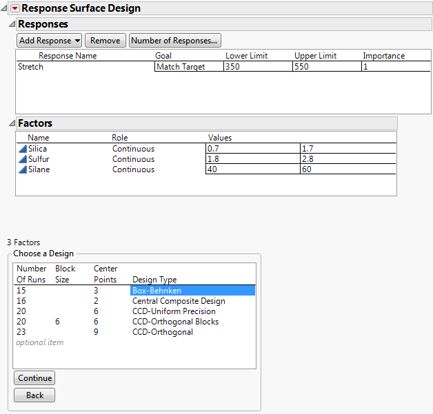

In this example, for convenience, you load the responses and factors from existing tables. When designing a new experiment on your own, enter the responses and factors manually. See Responses and Factors.
Select DOE > Classical > Response Surface Design.
Click the Response Surface Design red triangle menu and select Load Responses.
5.
Note: Setting the Random Seed in step 6 reproduces the exact results shown in this example. In constructing a design on your own, this step is not necessary.
6.
(Optional) Click the Response Surface Design red triangle menu and select Set Random Seed. Type 12345 and click OK.
7.
Click Continue to retain the Box-Behnken design selection.

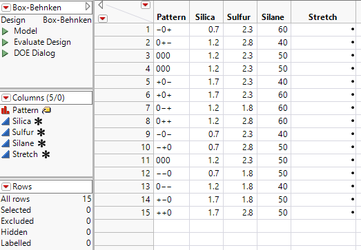

8.
Click Make Table.
