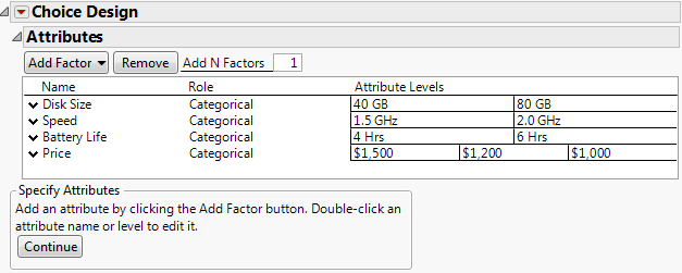

Select DOE > Consumer Studies > Choice Design.
Click the Choice Design red triangle and select Load Factors.
Click Continue.

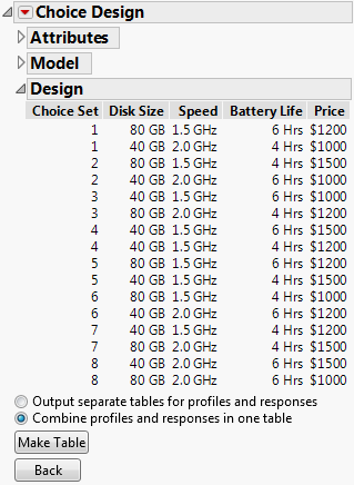

Click Make Design.
Note: Because choice designs are constructed using a random starting design, your design will likely differ from the one in Pilot Design.
Verify that the Combine profiles and responses in one table option is selected.
Click Make Table.
