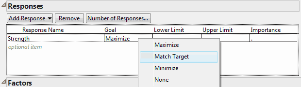

Note that the default Goal is Maximize. Your goal is to find factor settings that enable you to brew coffee with a target strength of 1.3, within limits of 1.2 and 1.4.
Click under Lower Limit and type 1.2.
5.
Click under Upper Limit and type 1.4.
6.
Leave the area under Importance blank.

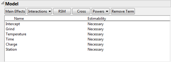

Design Generation Outline shows the Model outline. The Model outline is where you specify your assumed model, which contains the effects that you want to estimate. See Specify. The list that appears by default shows all main effects as Necessary, indicating that the design is capable of estimating all main effects. Because your main interest at this point is in the main effects of the factors, you do not add any effects to the Model outline.

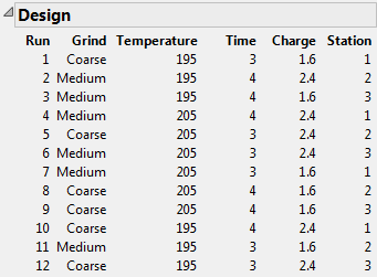

The Design outline shows the design (Design for Coffee Experiment). If you did not follow the steps in Steps to Duplicate Results (Optional), your design might be different from the one in Design for Coffee Experiment. This is because the algorithm begins with a random starting design.

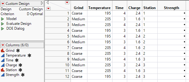

Click Make Table.
The data table shown in Custom Design Table opens. Keep in mind that, if you did not follow the steps in Steps to Duplicate Results (Optional), your design table might be different. Your design table represents another optimal design.
