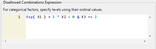

Defines disallowed combinations and other constraints as Boolean JSL expressions in a script editor box. See Use Disallowed Combinations Script.

Enter the expression (Exp(X1) + 2*X2 < 0) & (X3 == 2) into the script window.
