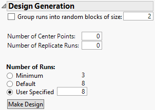

(Not available if a blocking factor is specified) To construct a random block design, enter the number of runs that you want in each block. When you specify the sample size, a factor called Random Block is created. Its levels define blocks of a size that is consistent with the block size that you entered, given the specified number of runs. If the number of runs is an integer multiple of the block size, the block sizes equal your specified value.
Appears when you specify a hard or very-hard-to-change factor. The factor Whole Plots corresponds to the very-hard-to-change factors (split-split-plot design), if there are any, otherwise to the hard-to-change factors (split-plot design). JMP suggests a value for the number of whole plots that maximizes the information about the coefficients in the model. Or, you can enter a value for the number of whole plots. For details, see Numbers of Whole Plots and Subplots.
Appears when you specify a very-hard-to-change factor. The factor Subplots corresponds to the hard-to-change factors in the split-split-plot design. JMP suggests values for the number of whole plots and subplots that maximize the information about the coefficients in the model. Or, you can enter a value for the number of subplots. For details, see Numbers of Whole Plots and Subplots.
Select this option to create a strip-plot (also known as two-way split-plot or split block) design. This option creates a design where the hard-to-change factors are randomized within the levels of the very-hard-to-change factors. They are not nested within the very-hard-to-change factors.
Appears only if the design contains factors with a Continuous or Mixture factor type. Specify how many additional runs you want to add as center points to the design. A center point is a run whose setting for each continuous factor is midway between the high and low settings. See Center Points, Replicate Runs, and Testing in Starting Out with DOE.
Specify the number of replicate trials that you want to add to the design. This does not replicate the entire design, but chooses the optimal design points to replicate. See Center Points, Replicate Runs, and Testing in Starting Out with DOE.
A lower bound on the number of runs necessary to avoid failures in design generation. When you select Minimum, the resulting design is saturated. There are no degrees of freedom for error.
Specify the number of runs that you want. Enter that value into the Number of Runs text box. This option enables you to balance the cost of additional runs against the potential gain in information.
Once you have completed the Design Generation outline, click Make Design. Custom Design generates the design, presents it in the Design outline, and provides evaluation information in the Design Evaluation outline. The Output Options panel also appears, allowing you to create the design table.
