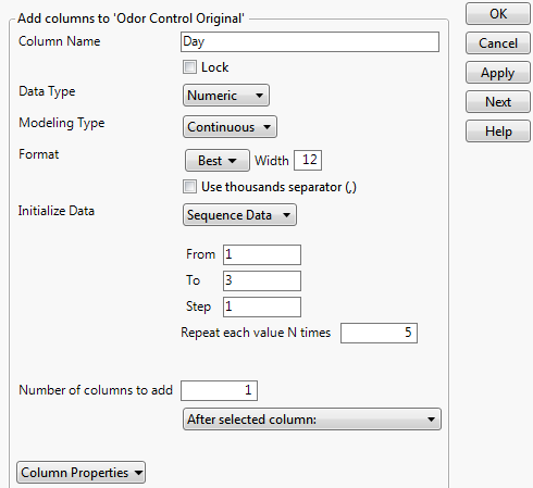

Select Cols > New Columns.
Next to Column Name, type Day.
5.
From the Initialize Data list, select Sequence Data.
1 for From
1 for Step
5 for Repeat each value N times
7.
Next to Number of columns to add, type 1.
Completed New Columns Window
