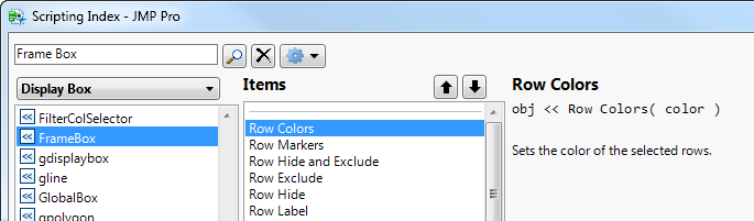

To find out which messages you can send to a frame box, select Help > Scripting Index and search the Display Box list for “frame box” (Scripting Index Display Box List).
