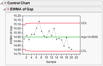

The following example uses the Clips1.jmp data table.
Select Analyze > Quality and Process > Control Chart > EWMA.
5.
Change the Weight to 0.5.
6.
Click OK.
EWMA Chart displays the EWMA chart for the same data seen in UWMA Charts for the Clips1 data. This EWMA chart was generated for weight = 0.5.
