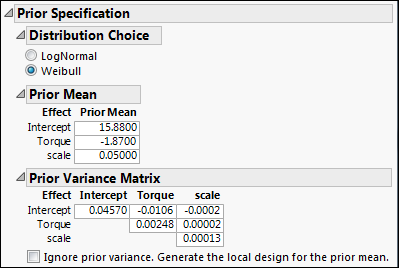

Under Prior Mean, enter your prior acceleration model parameter estimates, rounding the values shown in the Estimates report in Fit Life by X Model for Prior Data to two decimal places:
Next to Intercept, type 15.88.
Next to Torque, type -1.87.
Next to scale, type 0.05.
De-select the option Ignore prior variance. Generate the local design for the prior mean.
In the row and column for Intercept, click on 0.10000 and type 0.04570.
In the row for Intercept and column for Torque, click on 0.00000 and type -0.01062.
In the row for Intercept and column for scale, click on 0.00000 and type -0.00015.
In the row and column for Torque, click on 0.10000 and type 0.00248.
In the row for Torque and column for scale, click on 0.00000 and type 0.00002.
In the row and column for scale, click on 0.10000 and type 0.00013.
Completed Prior Specification Outline

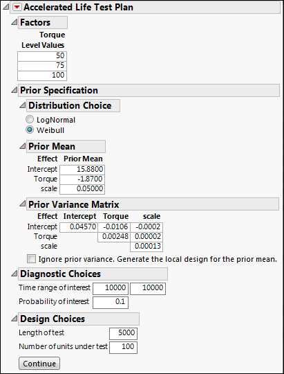

Under Diagnostic Choices, enter 10,000 for both boxes for Time range of interest. Leave the Probability of interest value set to 0.1.
7.
Enter 100 for Number of units under test.
Completed Design Details Window shows the completed Accelerated Life Test Plan outline.
