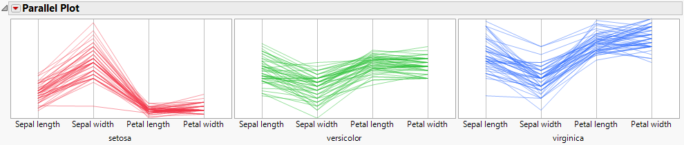

The following example uses the Fisher’s Iris data set (Mardia, Kent, and Bibby 1979). The Iris.jmp sample data table contains measurements of the sepal length and width and petal length and width in centimeters for three species of Iris flowers: setosa, versicolor, and virginica. To find characteristics that differentiate the three species, examine these measurements.
Select Graph > Parallel Plot.
Select the Scale Uniformly check box.
5.
Click OK.
From Three Species in One Parallel Plot, you observe the following:
