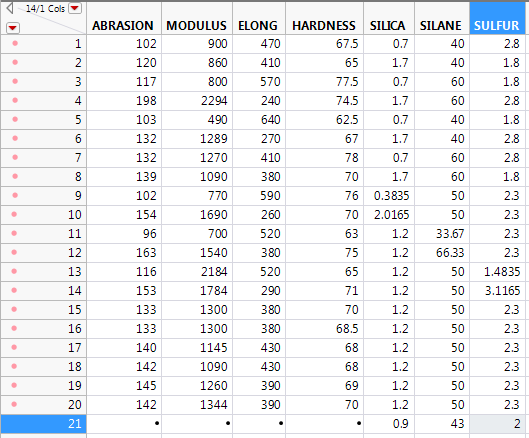

You now have predictions for ABRASION for each observation in the data table, as well as the standard errors for those predictions. Suppose that you have an observation with new values of 0.9, 43, and 2 for SILICA, SILANE, and SULFUR, respectively. You can predict the ABRASION response and obtain a confidence interval for that prediction because the Save Prediction Formulas option saves the regression equation for each bagged model. Therefore, M predictions are made with the new factor values to create a distribution of possible predictions. The mean is the final prediction, but analyzing the distribution tells you how accurate the prediction is.
In the data table, select Rows > Add Rows.
Under the SILICA column, type 0.9 in the box for the new row.
Under the SILANE column, type 43 in the box for the new row.
5.
Under the SULFUR column, type 2 in the box for the new row.
6.

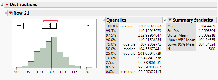

Select Analyze > Distribution.
10.
11.
Click OK.
12.
From the red triangle menu next to Row 21, select Display Options > Horizontal Layout.
The Distribution Report in Distribution Report contains information about the distribution of the predicted values of ABRASION from each bagged model. The final prediction of ABRASION for the new observation is 104.45, which is the mean of all the M bagged predictions. This prediction has a standard error of 4.56. You can also create confidence intervals for the new prediction using the quantiles. For example, a 95% confidence interval for the new prediction is 95.89 to 113.00.
