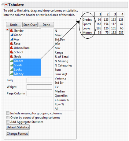

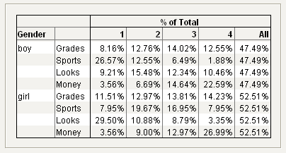

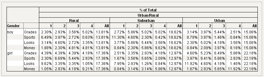

You have data from students indicating the importance of self-reported factors in children’s popularity (grades, sports, looks, money). Suppose that you want to see all of these factors in a single, combined table with additional statistics and factors. You want the table to look like Adding Demographic Data.
Select Analyze > Tabulate.
Drag Gender into the empty heading at left.
5.
Drag % of Total above the numbered headings.
6.
Drag All beside the number 4.
7.
