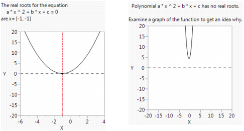

Clicking OK, displays a results window (The Custom Platform’s Report, left), with either the roots or an error message. Rerun the script, input 5, 4, and 5 respectively and click OK. Note that JMP displays an error message (The Custom Platform’s Report, right).
