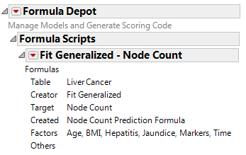

Click the red triangle next to Adaptive Lasso with Validation Column and select Save Columns > Publish Prediction Formula.
To add the prediction formula to the data table, select Run Script from the Fit Generalized - Node Count red triangle menu in the Formula Depot.
5.
To generate C scoring code for use outside of JMP select Generate C Code from the Fit Generalized - Node Count red triangle menu. A script window appears containing the C code. See Generating Scoring Code from the Formula Depot Platform.
